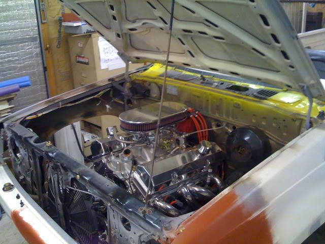

I have a sbc with a t350 trans in my 87 b2000 I can try to give u any help u need let me know on any questions u got I can try and answer and even post some pics if u need

I have a 350/700R4 in mine.
You need to make motor and transmission mounts.
Drive shaft, exhaust and cooling system need modification.
I would recommend finding a radiator that would be used by any car or truck that came factory with a 350, and make that work in your truck.
Most people say that you need to modify the firewall for the distributor to clear, but it isn't necessary.
Also, with a little creativity, you can even keep AC if you have it.
I don't have a build thread, but you can click this link to see what I've done.
