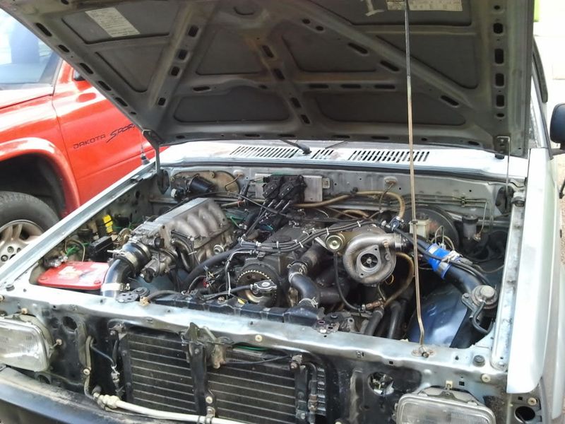

The only issue with using the manifold in question is that the turbo will be facing the wrong direction. Exhaust Housing will be facing toward the a/c compressor and the compressor inlet will be pointing toward the firewall. You'll lose your A/C if you have it that is. Since you are already fuel injected you have a great starting point. You can grab some stock injectors off the year model cars in question and they are 330cc (good up to 12psi or so). Also while your at it grab the FPR off the car as well. It should fit right up in the fuel rail in place of the stock B-Series FPR. Ignition, FORD EDIS is easiest with ms... all parts easily sourced from the junk.
If you need parts i have as allot of the stuff on my truck will be sold.
