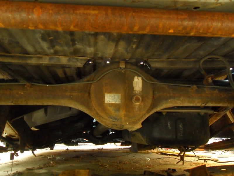

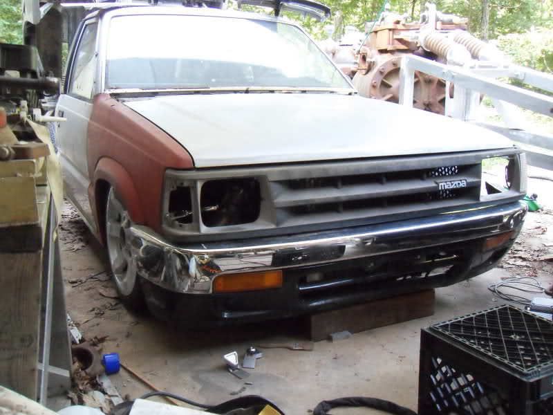

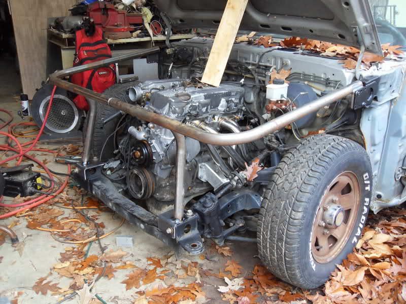

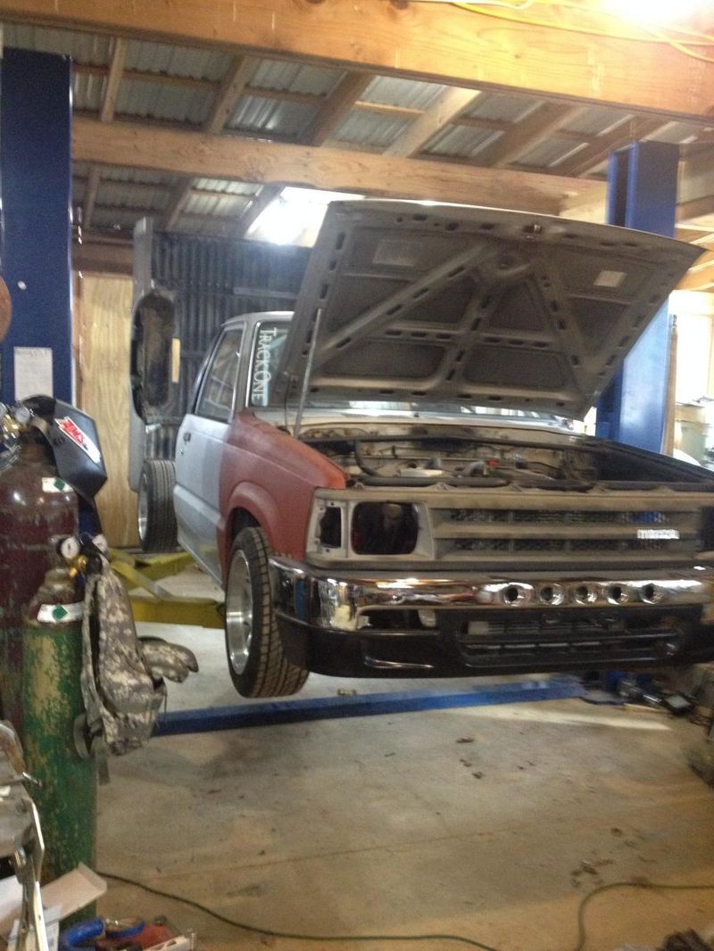

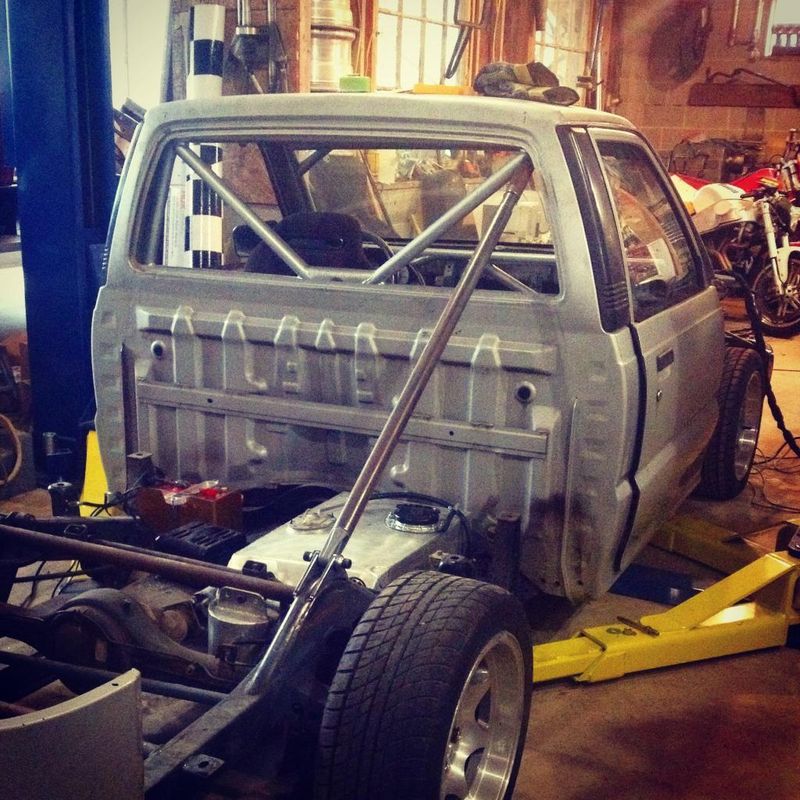

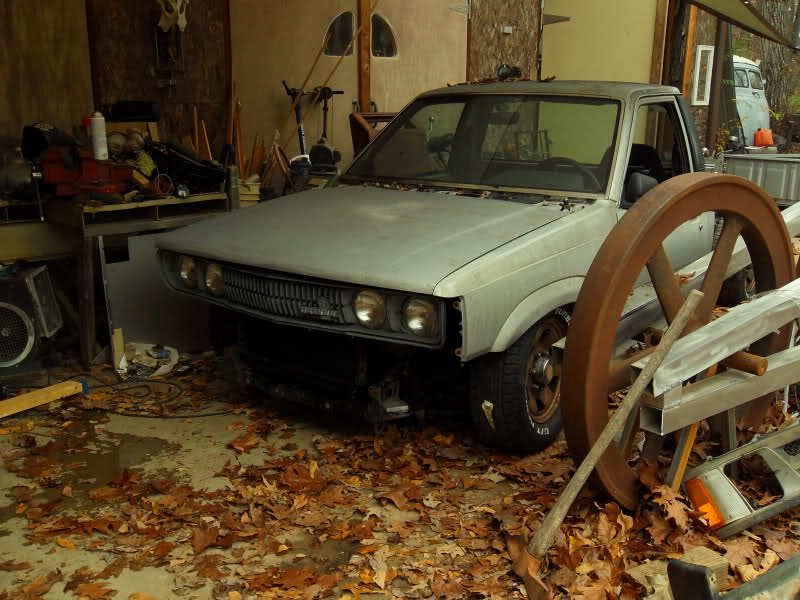

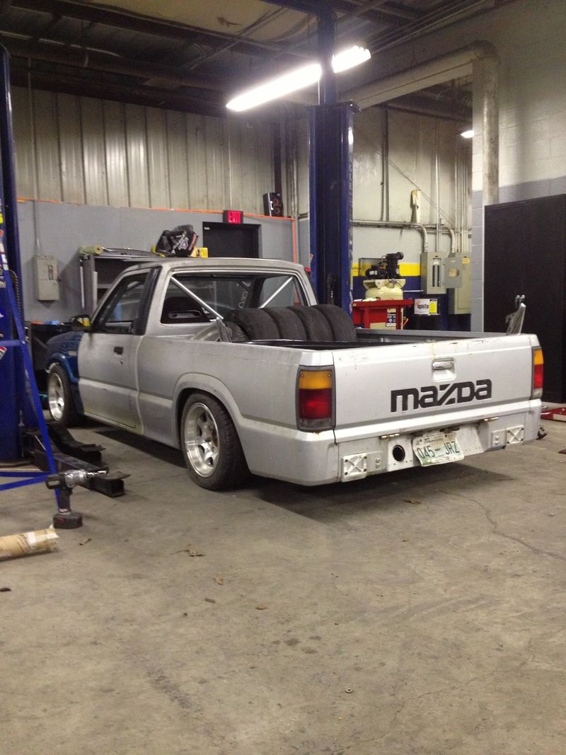

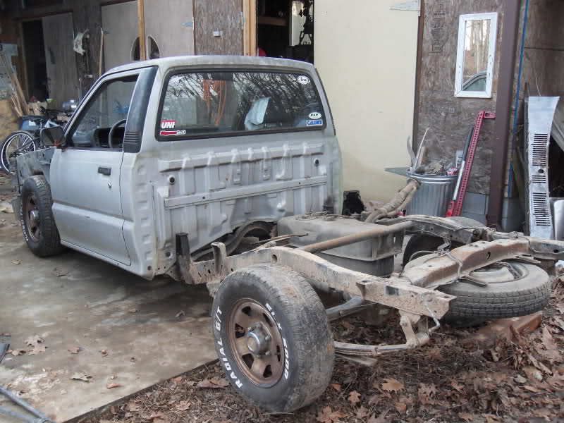

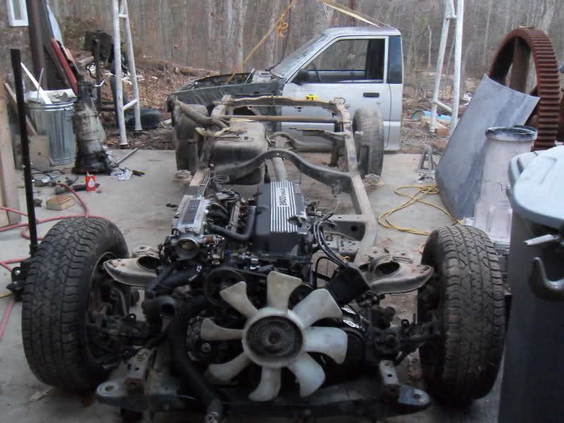

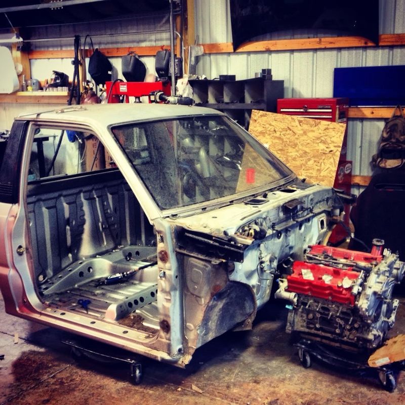

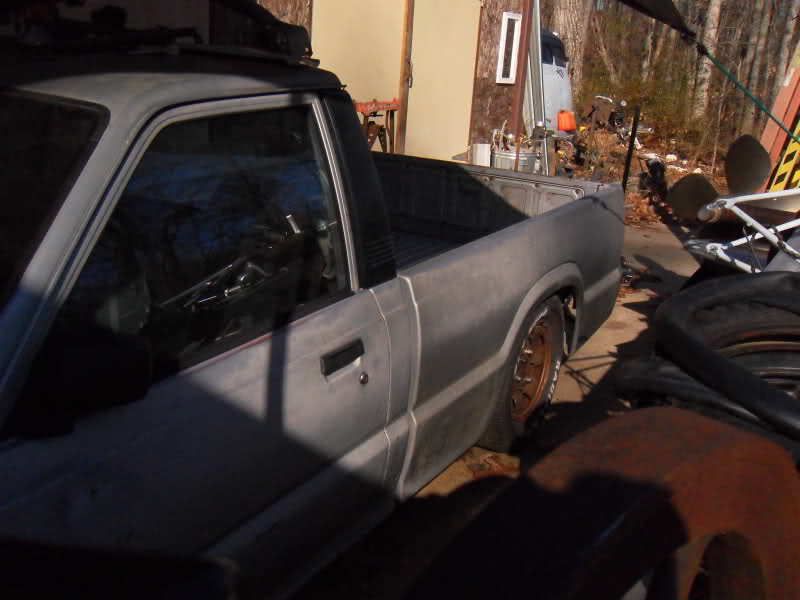

Here is the deal. Im rebuilding my 86 B2000 into a drift truck.
Details,

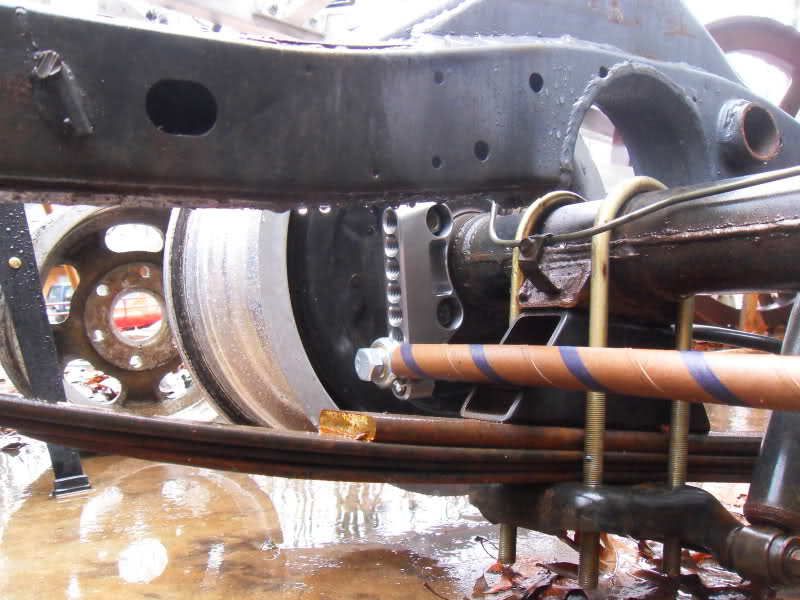

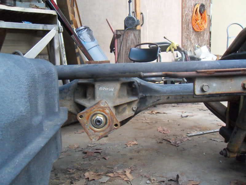

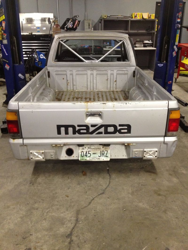

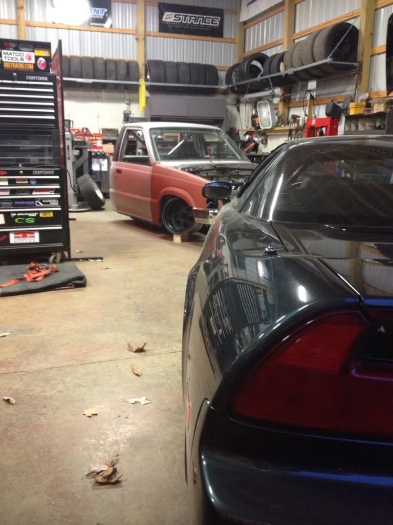

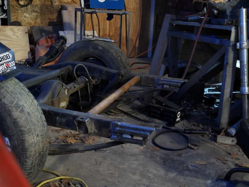

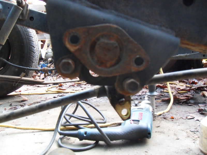

Static drop. frame and rockers 3 inches off ground
Body drop. Not sure if its going to be traditional or sectioned

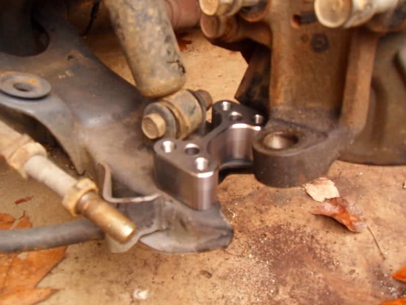

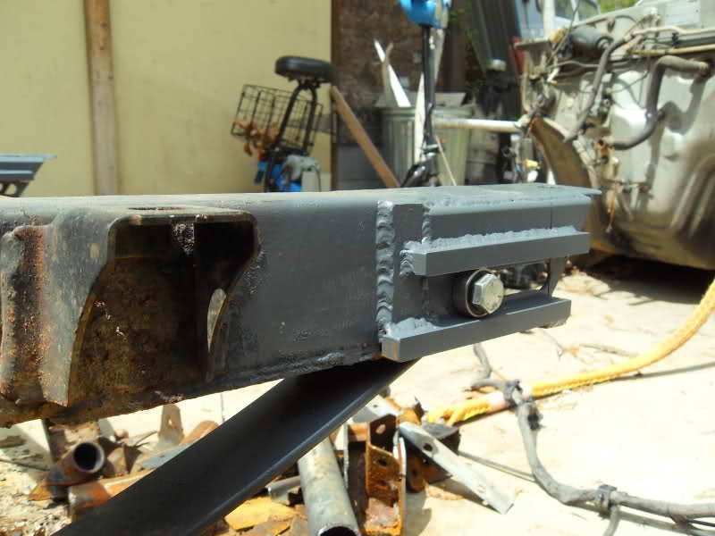

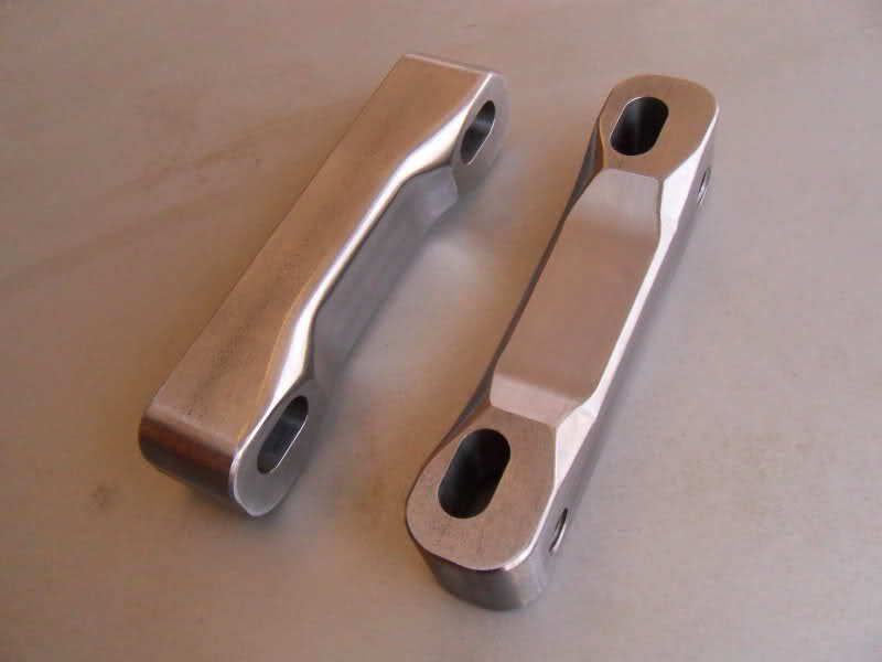

Suspension. Custom LCA's and coilovers. Repacked leafs and blocks.

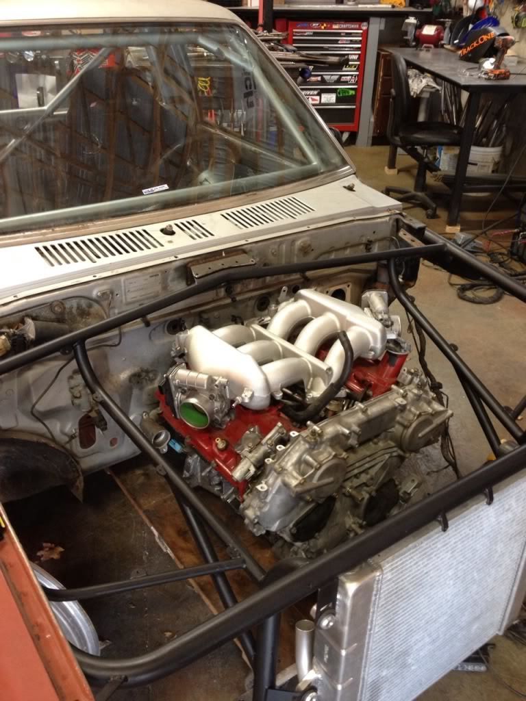

Engine. Mildly built NA stock motor for now, boosted KA24 DE later.

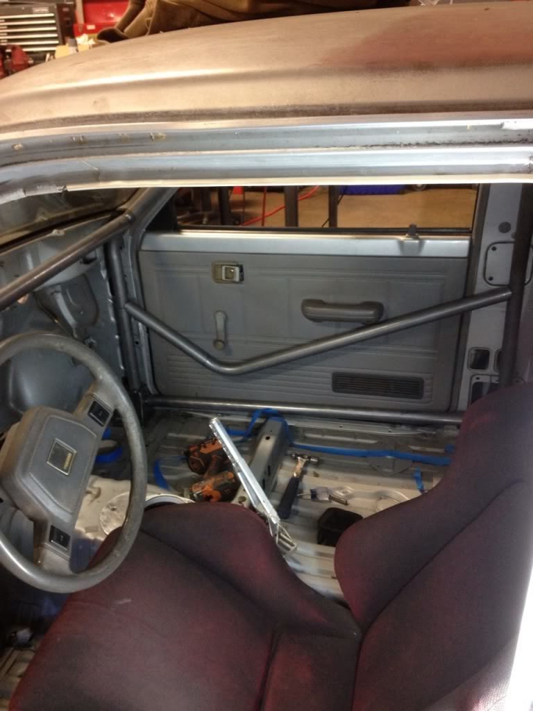

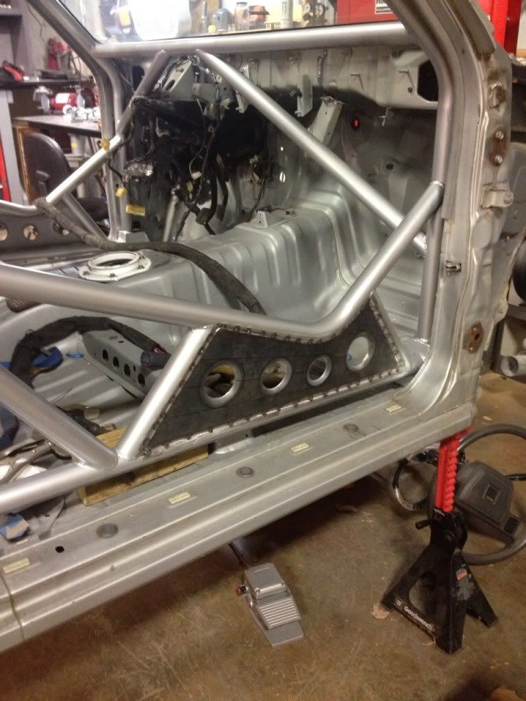

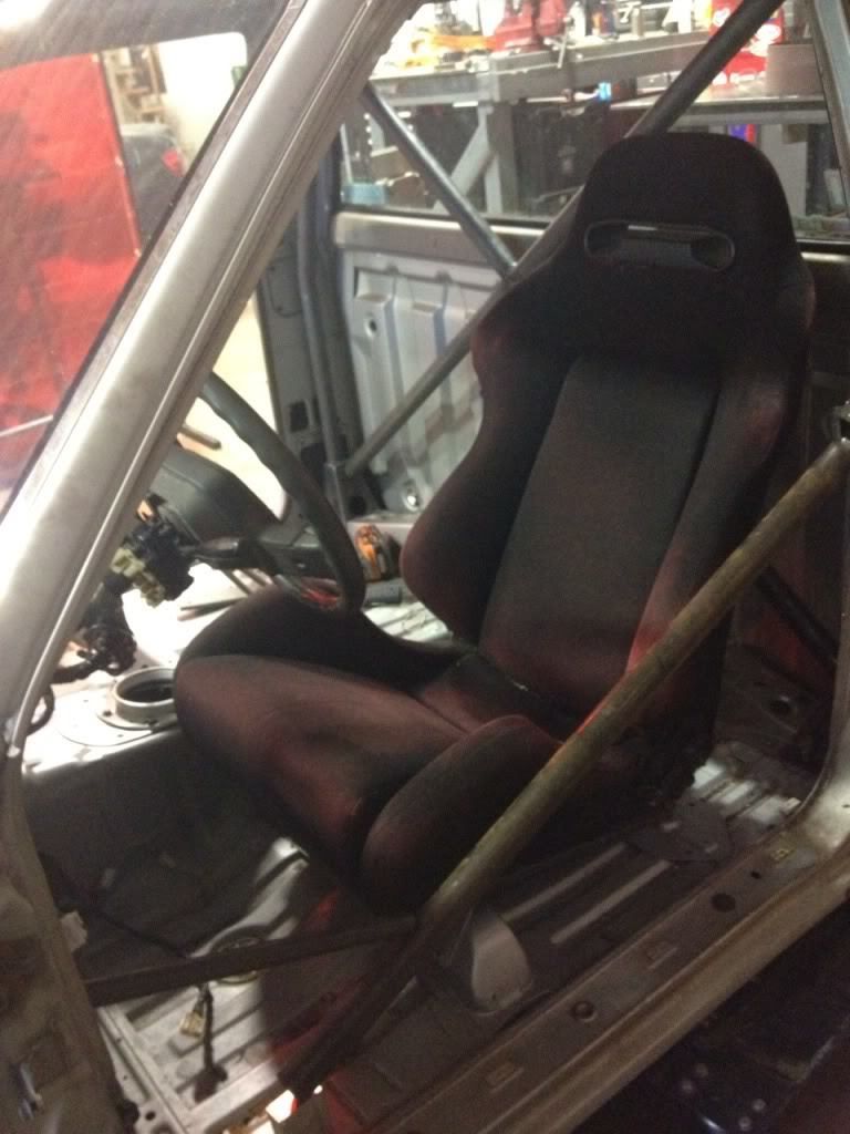

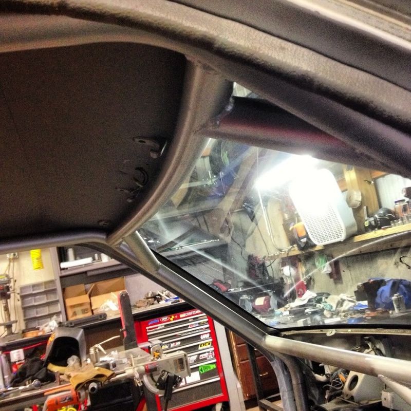

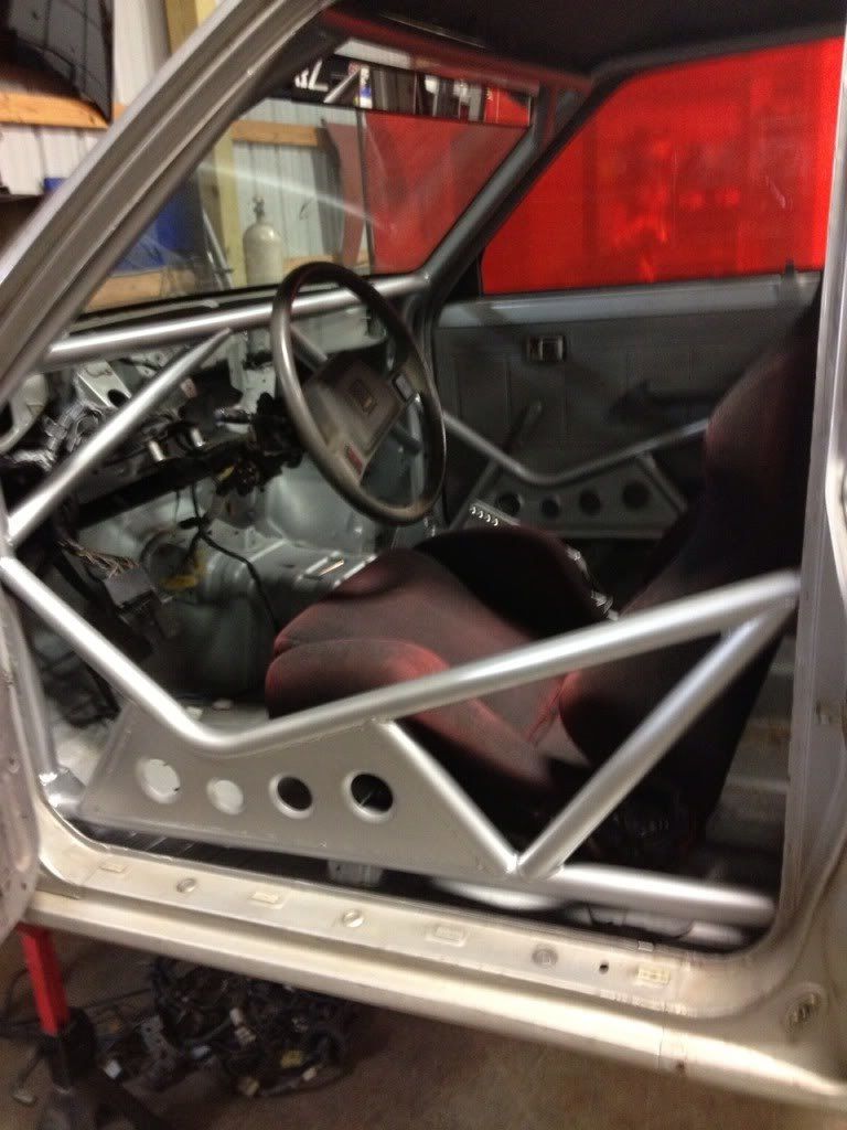

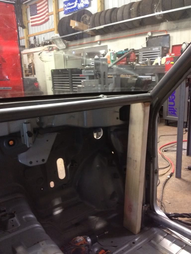

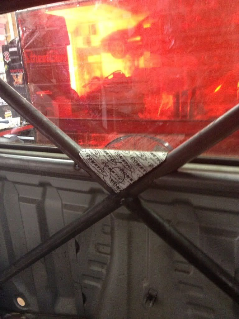

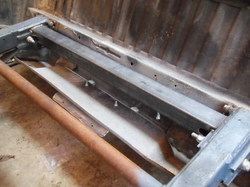

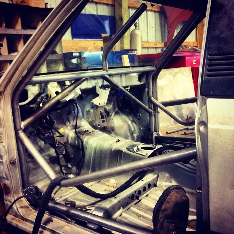

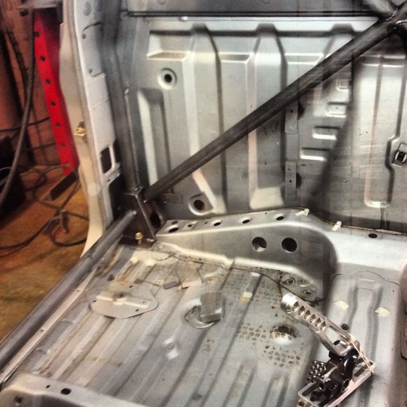

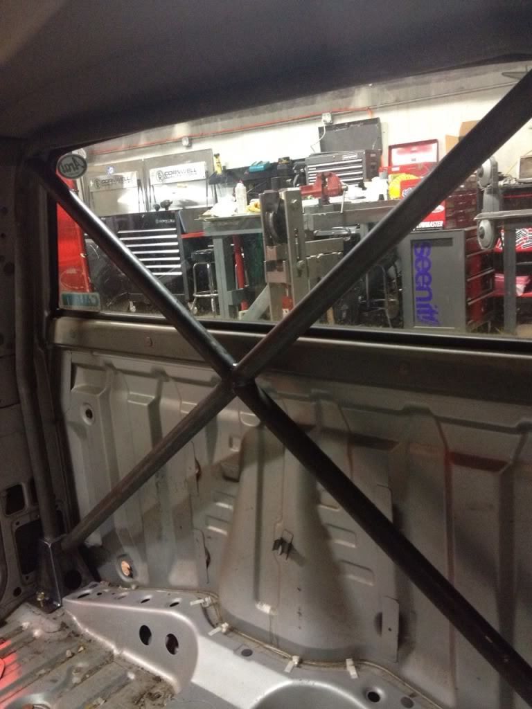

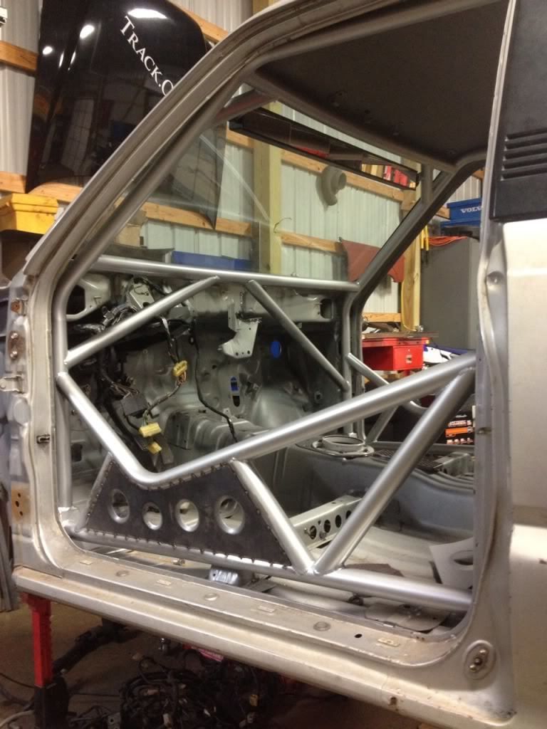

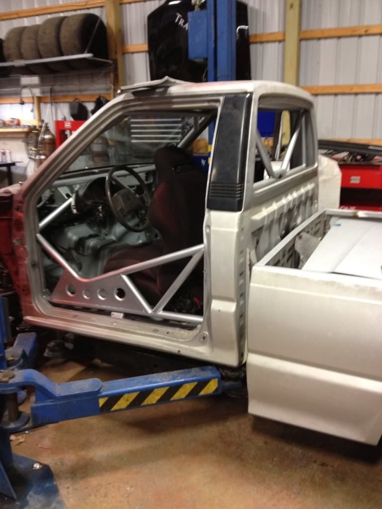

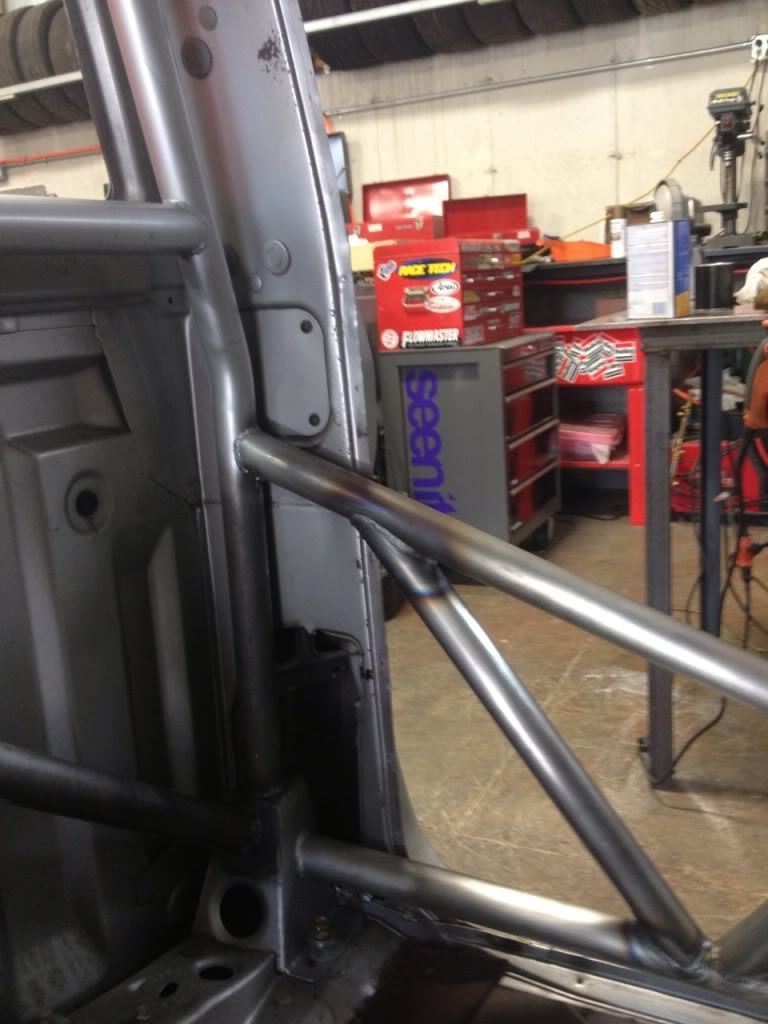

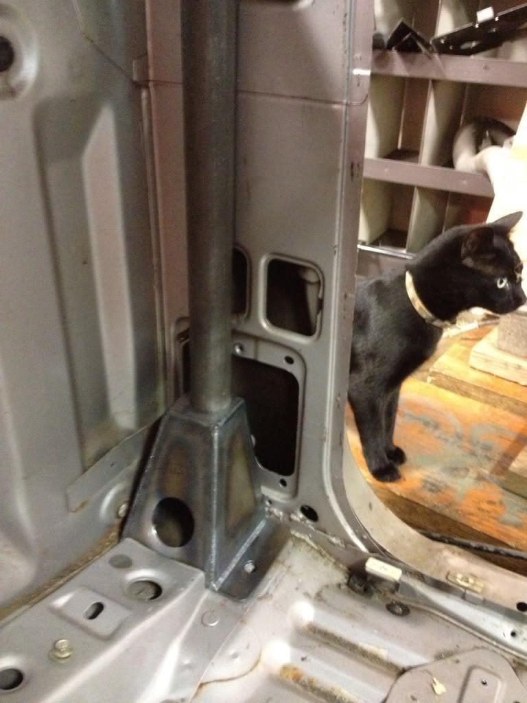

Full cage tied into bed. Bed floor will be raised and remain intact because I carry motorcycles often.
Hopefully I can set it up to tuck 20's, but I doubt ill run that big of wheels.

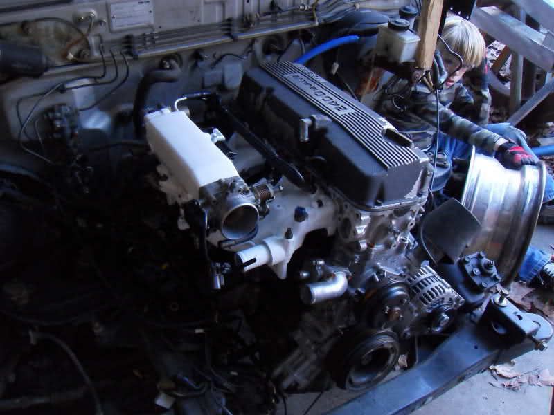

slowroller

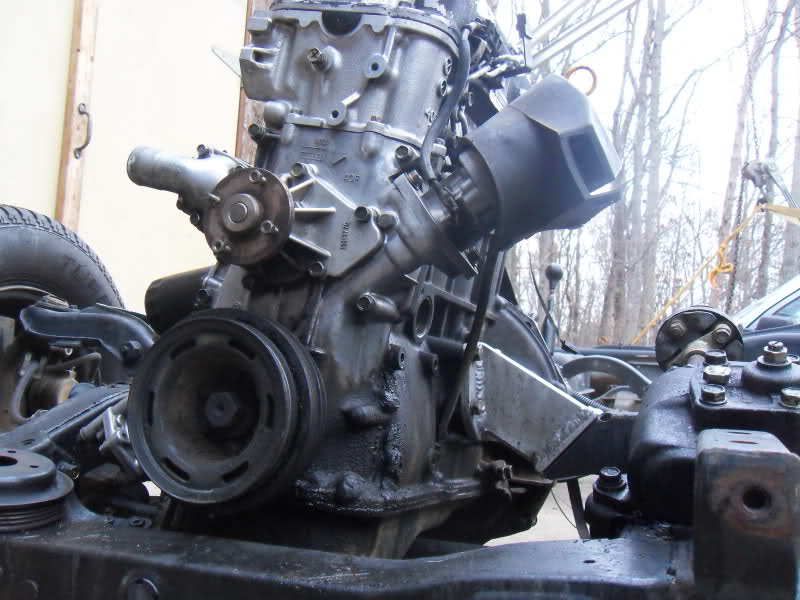

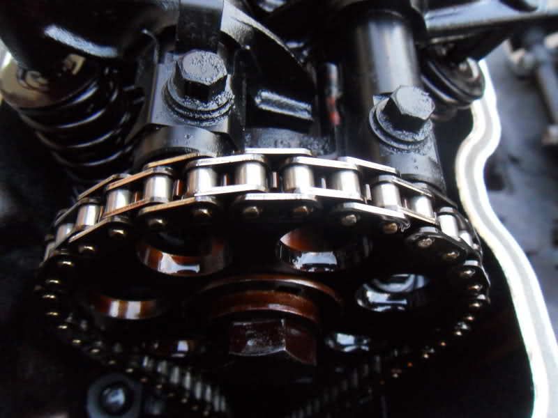

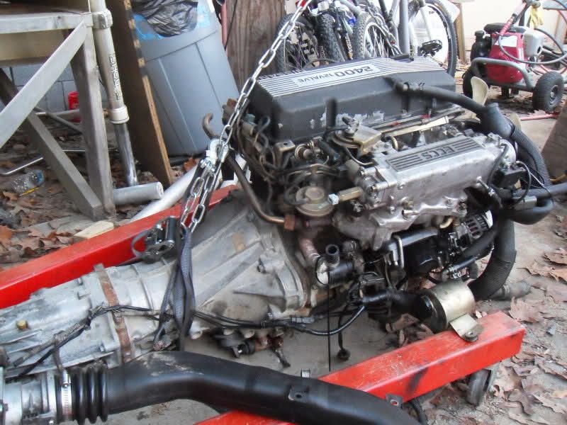

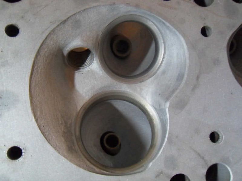

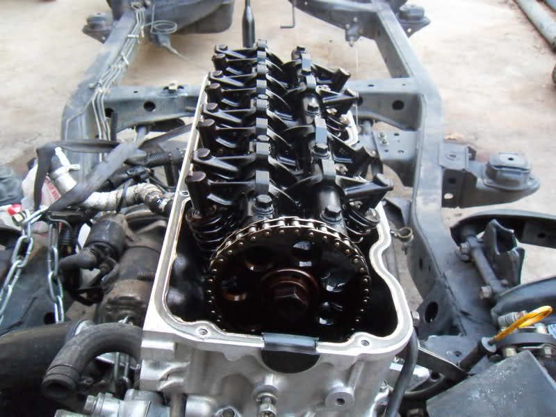

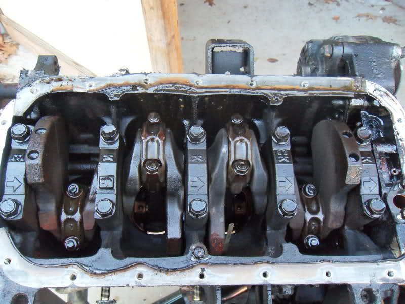

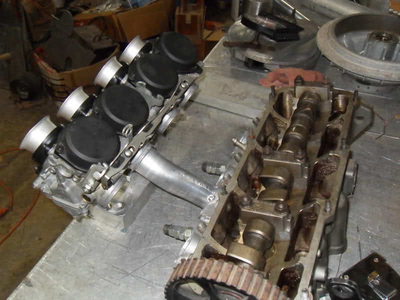

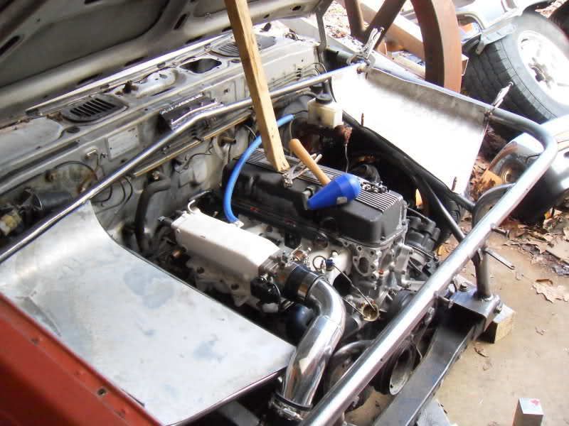

Im rebuilding the stock motor as cheaply as possible, as in gaskets and thats it.
polishing crank

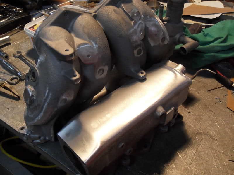

starting on the intake
O ringed
[/QUOTE]
slowroller
ported, will be shaved .020

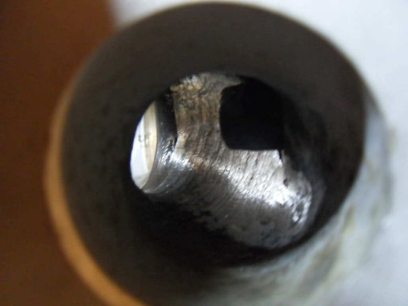

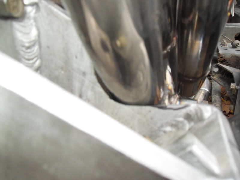

welded up the huge egr port in no. 1 cylinder. for those who dont know its about as big as a quarter, so it had to go.
and plugged the other side of the port

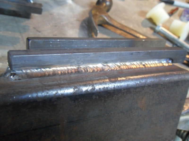

welded in some ridges to capture oil for the lobes.
[/QUOTE]

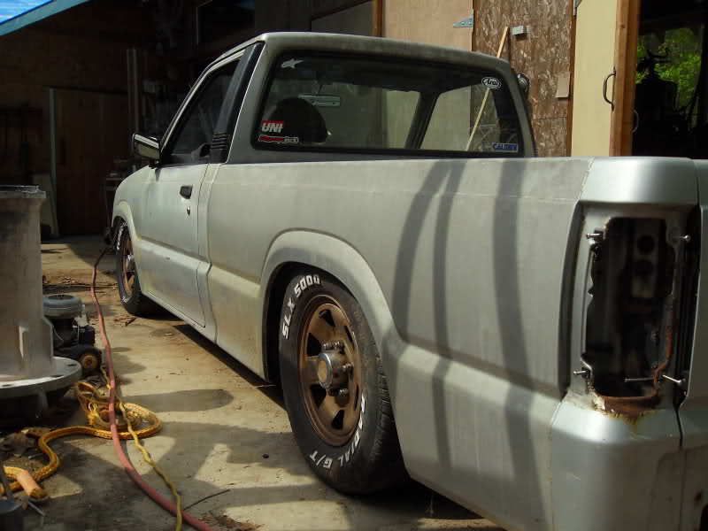

Hunter you have the wheels I want. I love those. I have some stock steel 17's ill run for now.

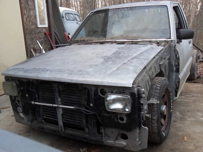

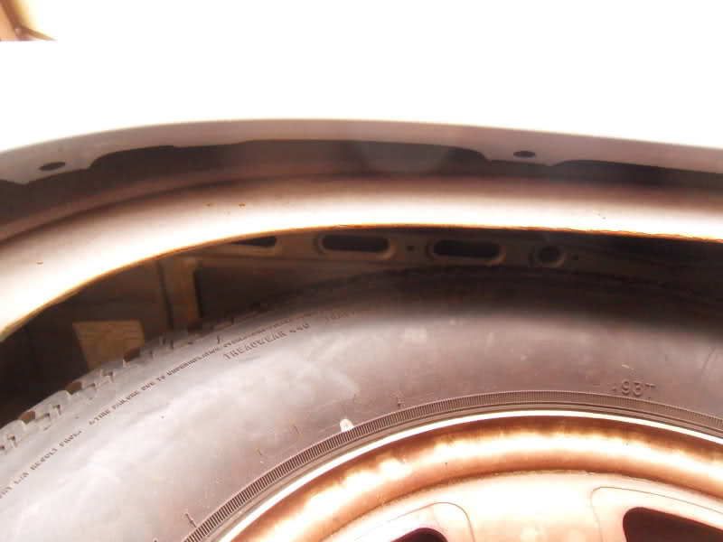

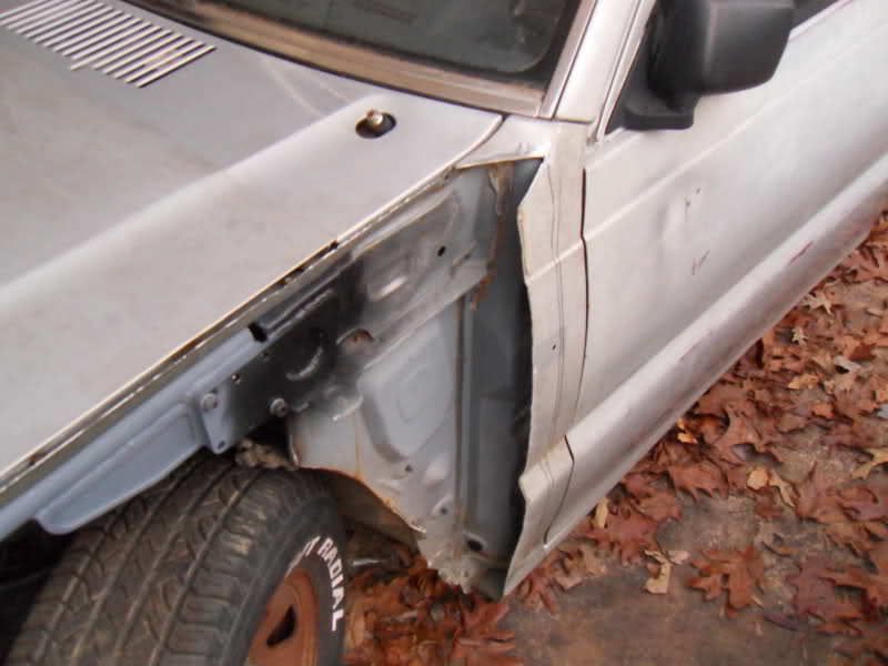

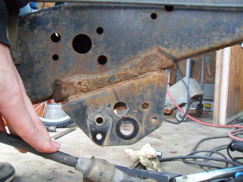

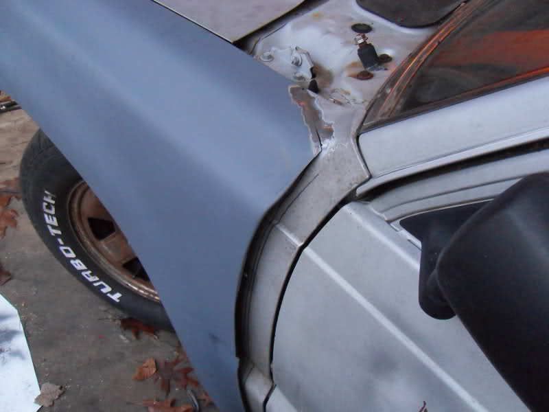

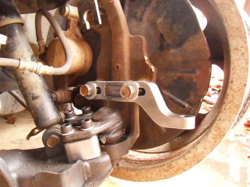

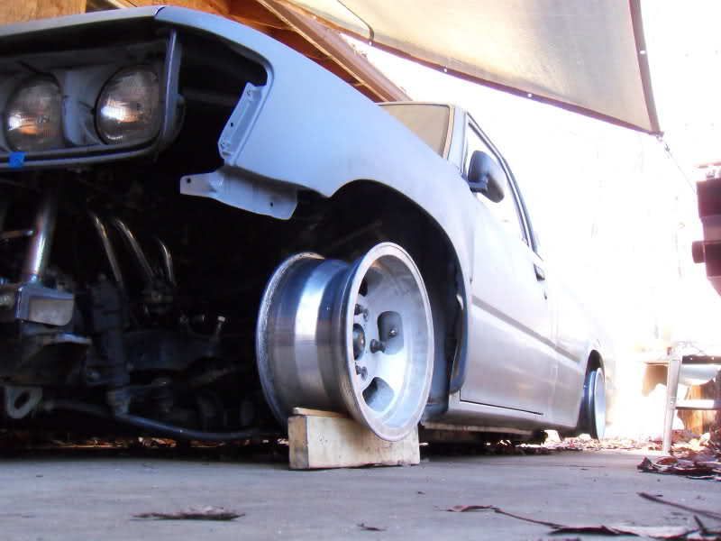

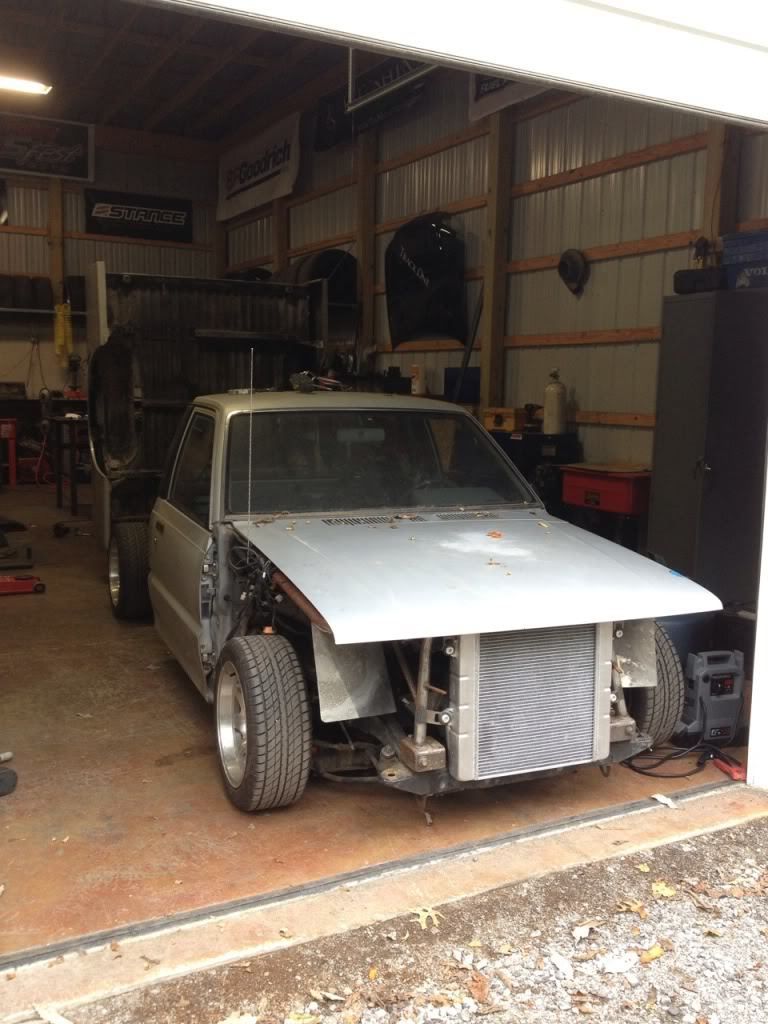

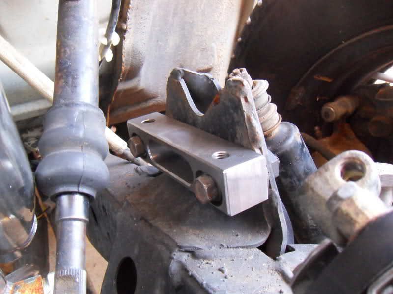

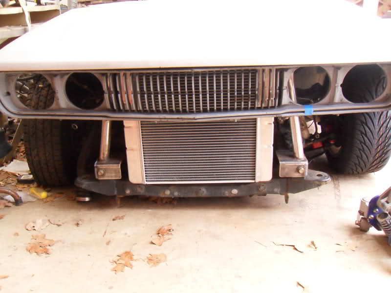

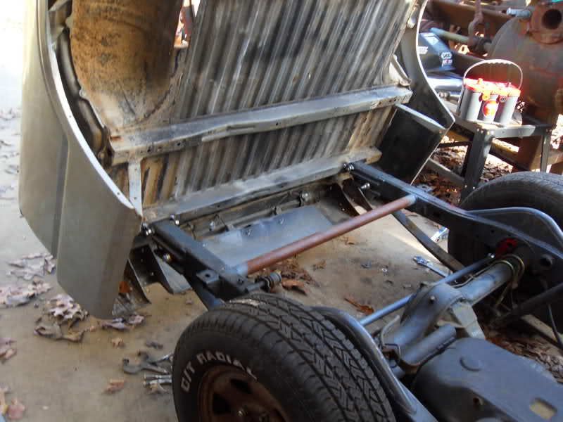

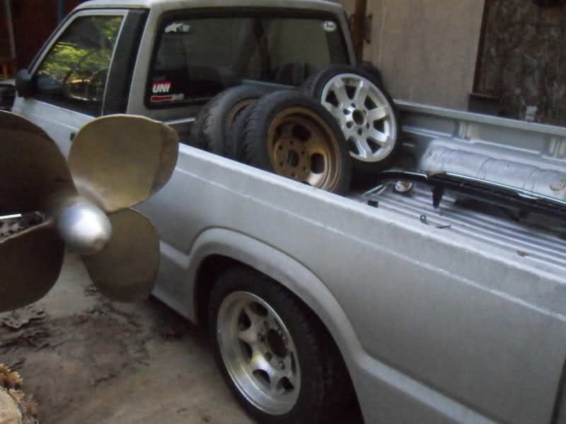

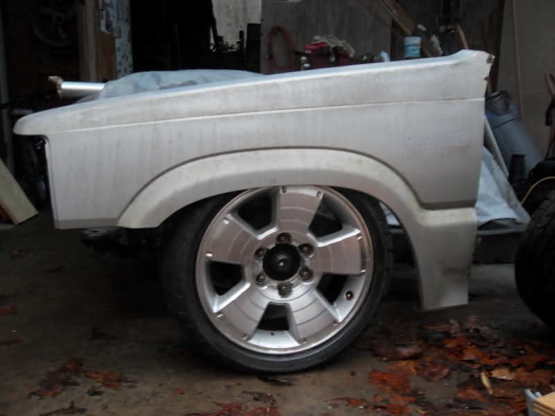

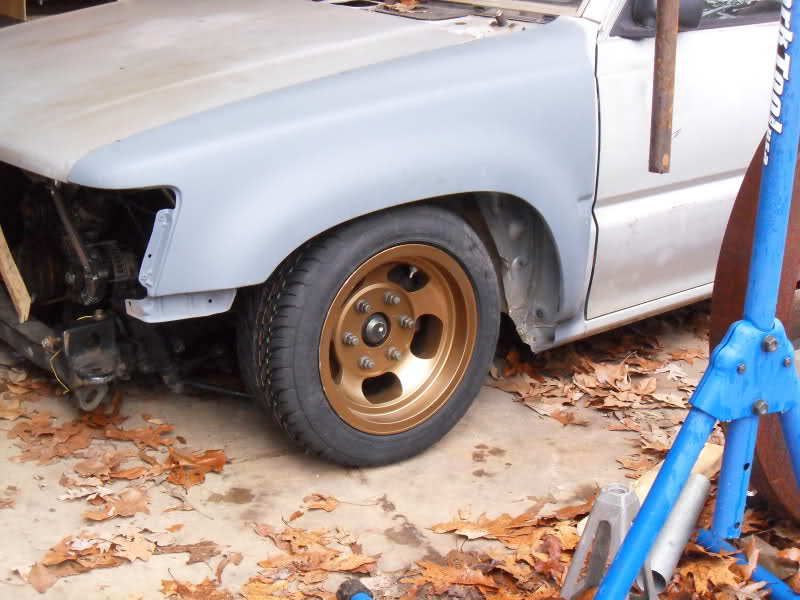

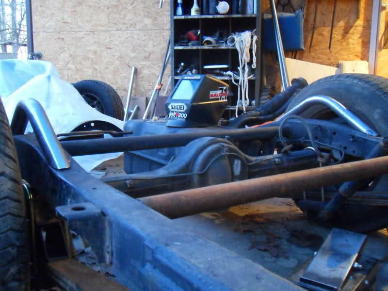

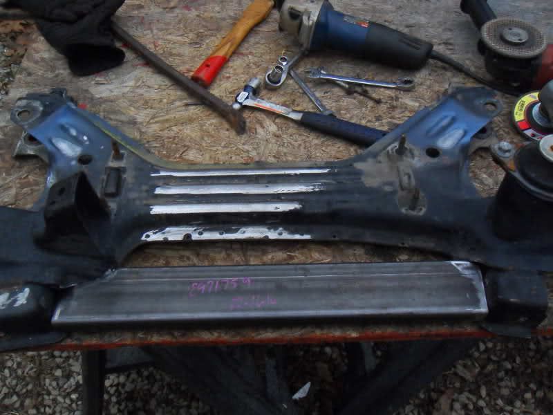

Here is my first big delima. This truck is going to be driven hard and I need a high steering angle. I will make tubular LCA's and may swap in a rack and pinion for high angles.
The problem is High steering angles and fenders. 4X4 fenders would be nice but I highly doubt there will be enough room.

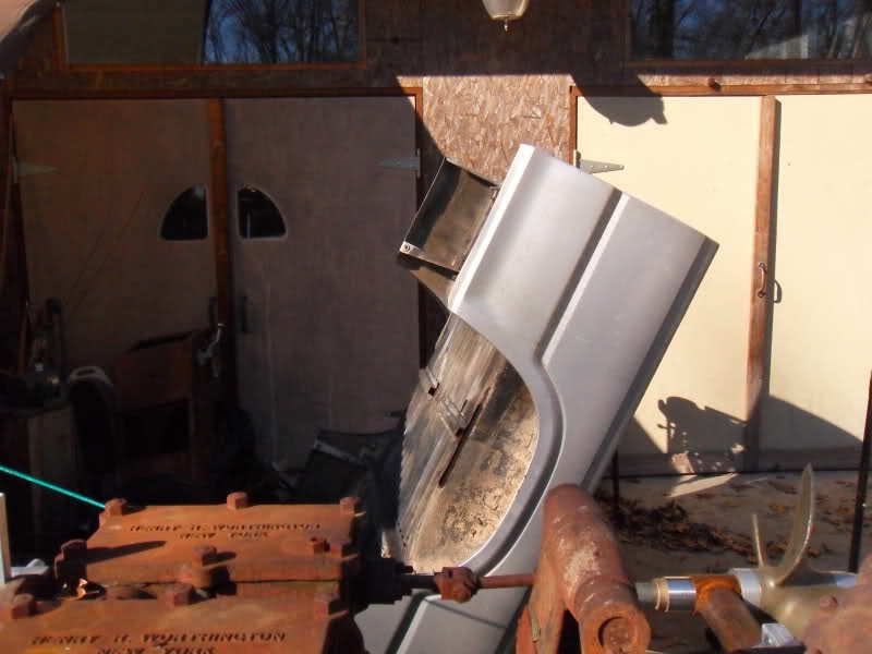

Im thinking about sectioning and widing the front fenders by about 1" to 1.5". I would cut the top edge right next to the hood and form a filler. There will be a gap at the end of the fender like widebody car fenders. Something like this...
I just dont know how it will look but It is the only option I can think of.
Anyone seen anything like this done to one of these trucks?
As a benefit I can see it evacuating more air from the engine compartment.
slowroller
these guys run small wheel tire combos and dont tuck tire much.
