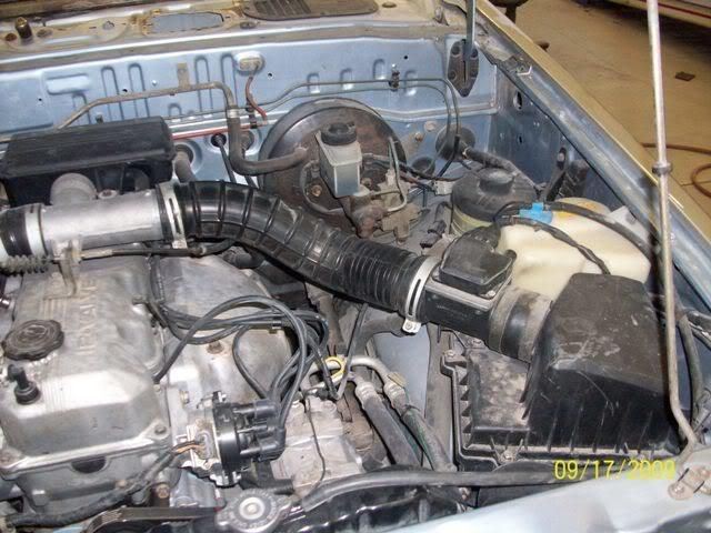

Like I said. . .posting some low res underhood pictures might help.
kev6772
Ok there are a few photos....... I have removed the Air Flow sensor and the truck ran longer than it had so far....which wasnt long at all. I tried getting the codes off of it by grounding the green wire under the hood and checking the check engine light....It did nothing at all.
