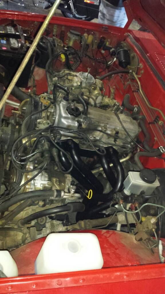

I've got a brand new Pacesetter header I'm going to be installing this weekend. My question is, am I going to be able to bolt this right on and up to the existing exhaust? Before I start I've got to clean up the ID of one of the tubes because one of the welds looks like Crap and is blocking a good amount of the tube. Once it's bolted up and flange slipped into place, will it bolt up to the existing flange on the front side of what would be the lower cat? I've already removed the second cat. I've Welded exhaust tubing in its place, but left the front flange in place. And I'll also be welding the header flange in place onto the header where is a slip for once it's fitted properly.

Got it installed today. Only a few hiccups. The header wanted to rattle against the bell housing on the Trans, so massaged the header slightly there to keep from rattling. Also. I trial fitted it in place and tacked the collector to the header then removed it to fully weld it. I slightly had to ball peen a primary tube to give a little better clearance for an A/C line. Also had to clean up the ports on the ID of 2 primary tube, because bad weld blocking it. All in all it went well. Haven't decided if I'm going to high temp paint it, or just wrap it....? Waiting to burn the rest of the cheap paint off first.

To really paint it right you'll have to sandblast it, or whatever you put on it will fall off.
You may consider a bracket to the bell housing, it is not a bad idea, like OEM.
