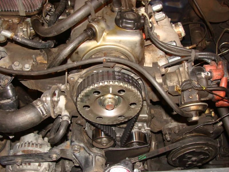

Can anybody send me their specs for an EGR blockoff plate on an 83 b2000? What do i do about a gasket?
Any ideas on how to plug the holes in the exhaust?
I'm tryin' too clen up the engine bay a bit more, i have the system bypassed but still 1/2 way hooked up.
Cheers!

Just draw one onto metal using your EGR gasket as a template. Make a mounting ear for a Weber return spring while you're making it (I forgot to do that with mine. I used a EGR gasket with Permatex Aviation to seal mine.
I plugged the four exhaust holes on on the exhaust manifold with solid lug nuts from O'Reillys ($6/set), believe these were 14mm x 1.5 thread. If you are talking about plugging the three rubber tubes near the air cleaner, I used rubber stoppers in those.
When I removed the metal tubes, I made a block off plate for that similarly, down under the first cat.

I have two metal tubes coming from the exhaust manifold; how do you have 4 holes???
The tubes are threaded on with nuts a lil bigger than 1 1/16 in (thats my biggest wrench and it ALMOST fits.
How did you get them off? i found a cresent wrench that fit but couldnt get them to budge, banged on it with a hammer too.

Exhaust manifold bots to cylinder head, unless you mean something else.
Lug nuts to cap off the four ports:
How did I get them off? Hand tools. Nothing that needed to be memorable.

The tubes coming out of my exhaust are LARGE, well the tubing isnt but the fittings are a good 1 1/16 inches
I dont think lugnuts are gonna fit

In the past I welded my ports shut, maybe a pic to help us visualize?
