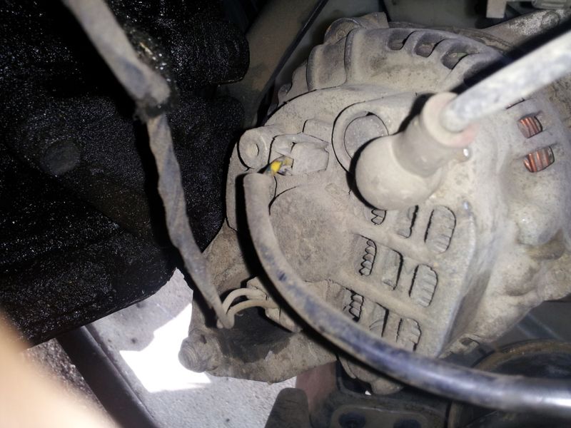

Here's a pic of the plug and wire for the choke

That single wire if is the one I'm talking about I have that doesn't go to anything but the wire on mine is red for some reason. I ran it down just a little while ago and ran it to the choke. It seems to be working ok. I'm going to try and adjust it in the morning when the engine is completely cold. I think it's working right although I never got a high idle. I can loosen and spin the choke housing and move the butterflies open or closed.
