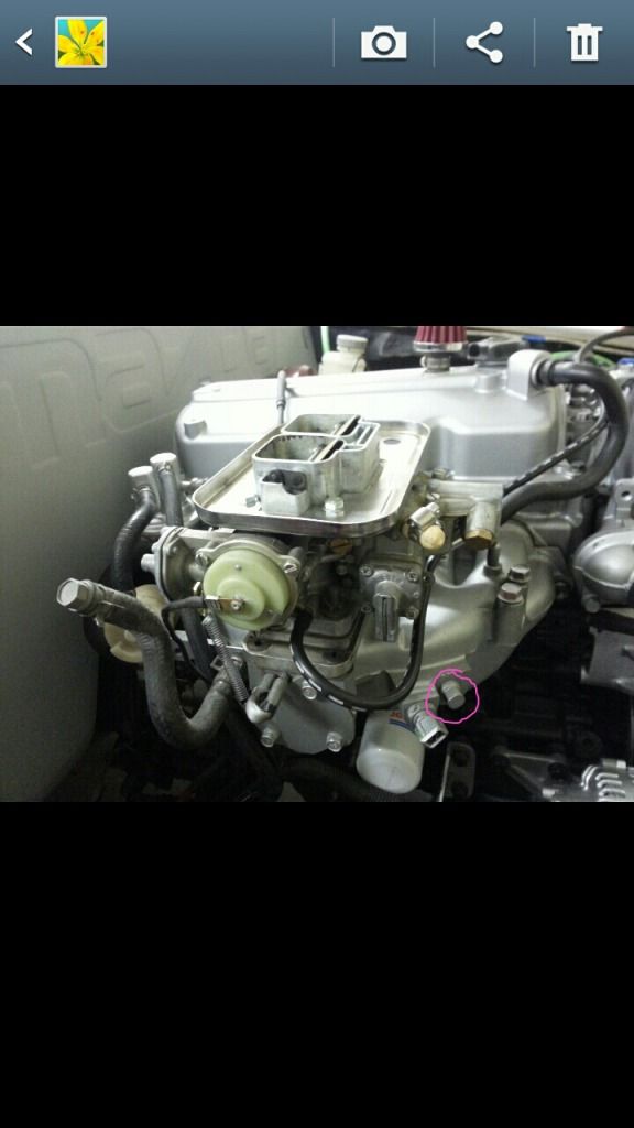

i got an oil press and engine temp sensor from autozone. just a run of the mill sun pro set. well oil pressure shouldnt be an issue but the plug that threads into our thermostats is too big? anybody else runnning aftermarket temp gauge...what brand is adaptable to this

Call SunPro and see if there's an adapter available. Or check VDO for an adapter, they make gauges too.
You basically need to know the thread size for the stock sending unit and the thread size for the SunPro sender.
Or just leave the stock sending unit in as a plug and tap into the coolant path elsewhere whee one of the other senders had been.

can i thread it into the intake mani? where the green plug is?
matt88brewer
i recant. there is a plug directly next to that green one and it looks identical in size. i think it should be fine in the manifold.anyone see any issues with it being there..

I think that should be fine. When one has a gauge (oil pressure, coolant temperature, etc.), what you're really looking for is something that changes from the norm.

Your EGR block off plate and hardware store throttle return spring look like mine. It looks like you were smarter than me and included an "ear" with a hole for the spring in your block off plate, I'll do that if I ever make another one.

Lol.cool. and yea the plate is ever so custom. Haha. But the spring came brand new with my weber .im hooking this gauge up tonight. Whats normal idle temp for. This engine. Its bored .30 over

Update.the kit came with a nifty brass adapter bushing and it went right in . No leaks no issues. Working as it should.
