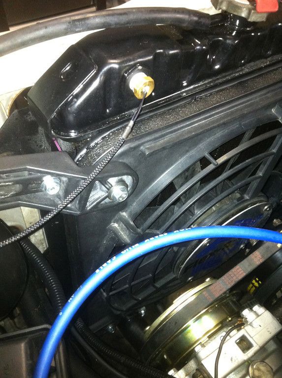

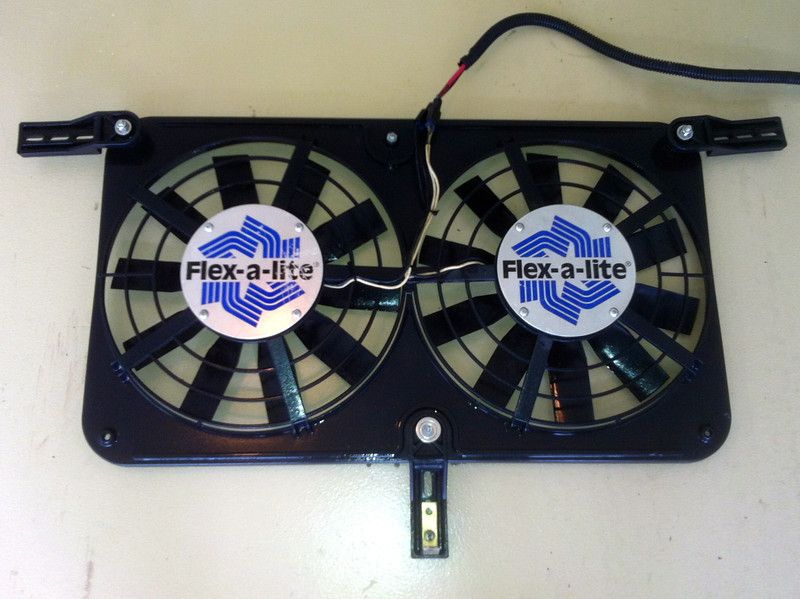

I installed a Flex-a-Lite fan (dual 12") on my B2600i several years ago. I bought their Variable Speed Controller to go with it. It was all a little pricey, but it had some features that made it nice. The VCS only came with a probe that you slide into the fins to read the radiator temperature. It worked, but wasn't the most consistent - sometimes kicking on cooler and sometimes warmer - but always within a safe range. I recently installed a new all metal radiator and took it to a shop to have a bung brazed in so that I could upgrade to a traditional sensor. It works much better and cycles the fans at a more consistent temperature.
A couple of the nice features of their VSC is that it has a soft start when it comes on so that it's less of a shock to your electrical system. It does make a little "chattering" sound as the fans spool up for a couple of seconds, but then it's quiet - except for the normal airflow sound. Another feature is that the fans only come up to 60% speed. If your temp continues to rise, or exceed the temp you have it set for by 10 degrees, then they spool up to 100%. Again, the idea being to reduce electrical load on your system. Mine never spools to 100%. The dual 12" fans are probably overkill for our little 4 cylinders, but I wanted maximum cooling for my condenser.
The variable speed controller also has inputs to it that will turn the fans on for your AC. Just tap into you compressor clutch lead wire, and plug the other end into the controller ac input. It also has terminal inputs so that you can manually turn it on or off - just bring your own switches.
No matter what fan type you go with, the good thing is that your radiator is already plumbed for a sensor/switch. That's not so easily added to most of the plastic tack radiators out there. You'll need to make sure of the mounting depth required because there is not a lot of room between the radiator, and the water pump (& former fan) pulley - at least on my G6 engine. In fact, I ended up trimming the studs on my water pump just a bit and have barely a 1/4" clearance. My new metal radiator sits a little more aft than the old plastic style because i used to have almost an inch of clearance.

Here's a couple of pics of the Flex-a-Lite install. You can see the water pump studs behind one of the plug wires. It's looks like an inch or more of clearance, but it's probably 3/8" to a 1/4".
