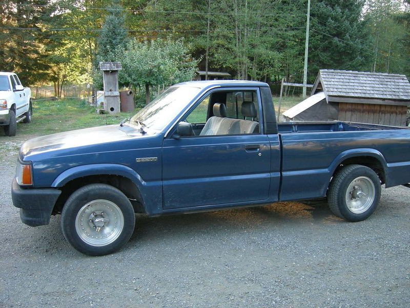

Hi guys, just wondering if anyone has run the weber High Performance 38/38 Carb on the stock motor? I am planning on doing a full engine rebuild and would like to get as much out of the truck as possible hence the 38/38 but I would also like to be able to drive the truck in the meantime until I get around to doing the rebuild.
If anyone has a preference on the 38/38 vs 32/36?
oh yeah 89 b2200 5 speed
Thanks.
