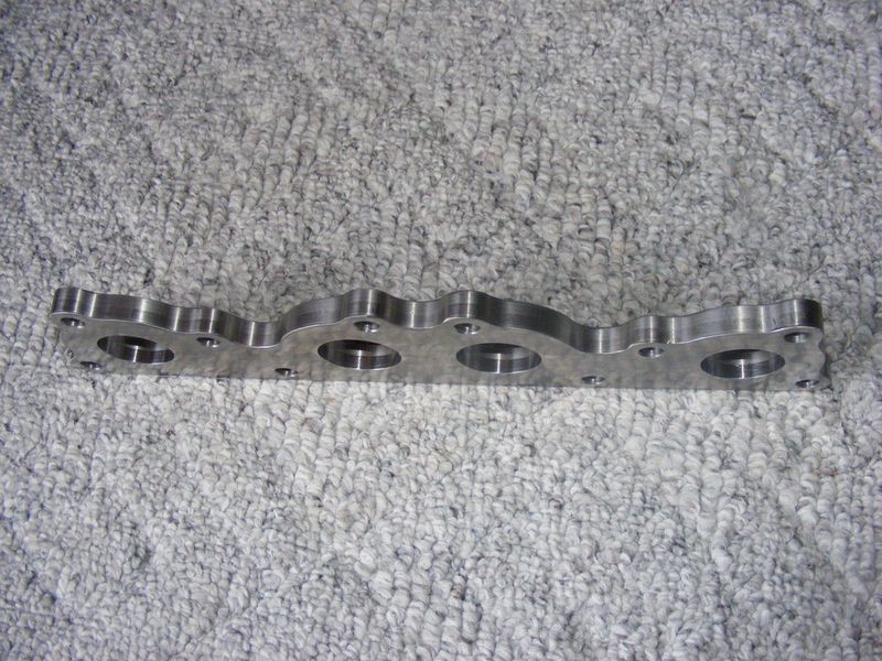

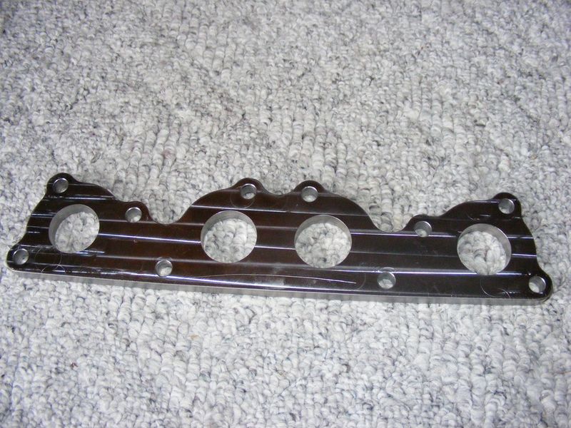

A good buddy of mine will machine out a header flange to fit your b26i cylinder head if you want. It will look like this. I had him do one for me. Good Luck! Let me know if you want his number.
This one looks bent but it is not...its an optical illusion.

I made one of those... Took me like 4 hours with a drill press, drill bits and hole saws, and grinder with cutting discs, grinding discs, and flapper discs... Lol

The one in the picture is made out of mild steel. I just called him. He still has the template and program made up to run these. The only problem here is the setup time to get everything into the machine. If we could find enough people together to punch out 4 of these it would be 100 dollars each. But if only one is ordered it is probably going to be more like 200 for one. There has been some inquiry on here about headers. Ask around and see.
mazda-man's avatar
mazda-man
Oh...and we made mine from 1/2" steel. That thickness should not warp. I guess that was before we milled it, so it is probably like .475" thick.
