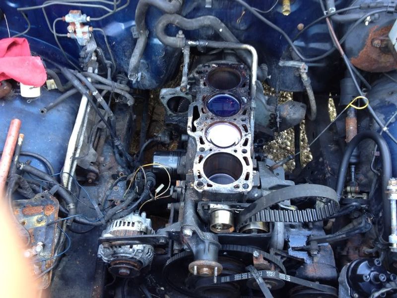

Hey.... I'm finally rebuilding the b.. I have an extended cab and I'm going with the pacesetter also.. So would everything goes good with the pacesetter on the extended cab... I seem mostly regular cabs with the set up,
Pressure wash and degreaser the entire undercarriage and engine bay
