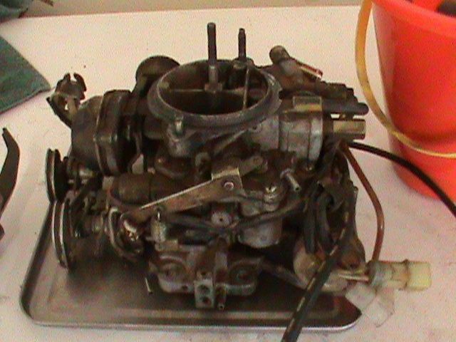

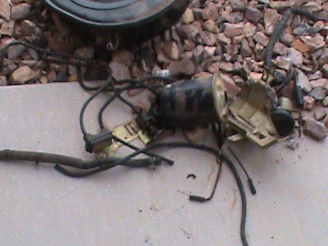

Ok here it is I'm trying to toss all the emissions crap on my 89' B22 and I've done pretty good at pulling stuff out.... I'm just not sure what to do with whats left.
Due to a sad budget and pressure of time i need to reuse the stock carb but I'm not sure whats what with half of it anyone got some picks to share so i know what a finished emissions removal should look like. i know what needs to bee hooked up i just need help to know where/how.
axel breaker earl's avatar
axel breaker earl
Well, the stock carb actually has to have most all of that emission stuff to operate without staying in limp mode. The fuel solenoid in the center of it has to have the input from the ECU and the ECU needs it's reading from the O2 sensor......and on and on.
There are too many devices hanging on the passenger fender that alter the signal to the stock carb........it'll run without them, but probably not very good, and the gas mileage will be worse.......it has a default "limp mode" in which the carb's idle gets tuned to a rich condition when something is off on the signals going to it.
Give it a shot though since you have removed it all and see what you get......plug all the open vacuum ports on the carb, and just use one that has vacuum on it for the vacuum advance on the distributor.
Let us know how it goes.

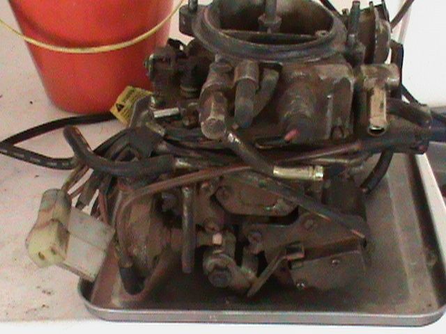

aquarian_aitrus
what about the sensor on the manifold between the carb and the distributor do i bypass that? i ca is a whole new beast to me n pull apart and rebuild almost everything between the clutch fan to the rear diff but the carb is a whole new beast. i wish i had a weber its so simple in comparison. on the plus side i have a few days till some gaskets show up to cram in time to tear this site apart for info.

and the poor pathetic carb

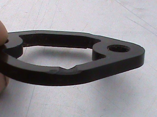

everything has a thick layer of dirt stuck to it i was loosing oil from my fuel pump due to a gouge in the spacer and i live in southern utah with dust galore

well i didnt get much info but i faked it the best i could and got her running again gotta figure out how to tune the carb now i think she is running to rich and she chugs/sputters after starting warm. fixed my fuel pump oil leak, now i dont spot everything i park on.
aquarian_aitrus
i really hate feeling stupid but where the hell is the ecu so i can unplug the damn thing i have the truck running so i can get to and from work but i have all these unplugged wires coming off the carb because i dont know what will happen if i plug them in before i find the ecu. i feel like im trying to unstrap a laptop from a lawnmower it just doesnt make sense to me. the only electrical i want running to the engine is what it needs to run(good).
tucknrimmaz's avatar
tucknrimmaz
its behind the kick panel on the passenger side below the dash.

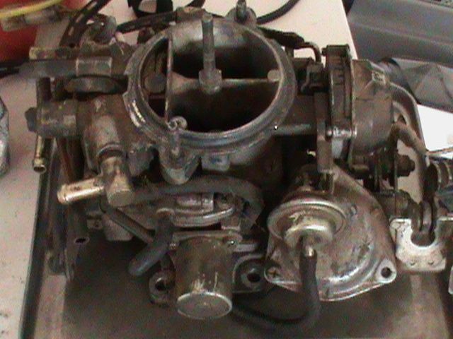

3. i have plenty of experience with tuning dirt bikes lawn mowers weed wackers esc. but i do not have a clue on this thing i have high and low idle figured out but thats it.
my last pick of the carb shows a rectangle with 2 holes at the base one has a screw in it what is that for?
