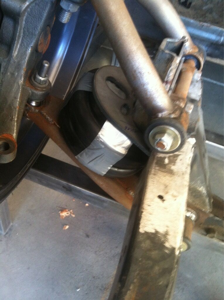

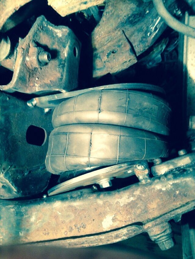

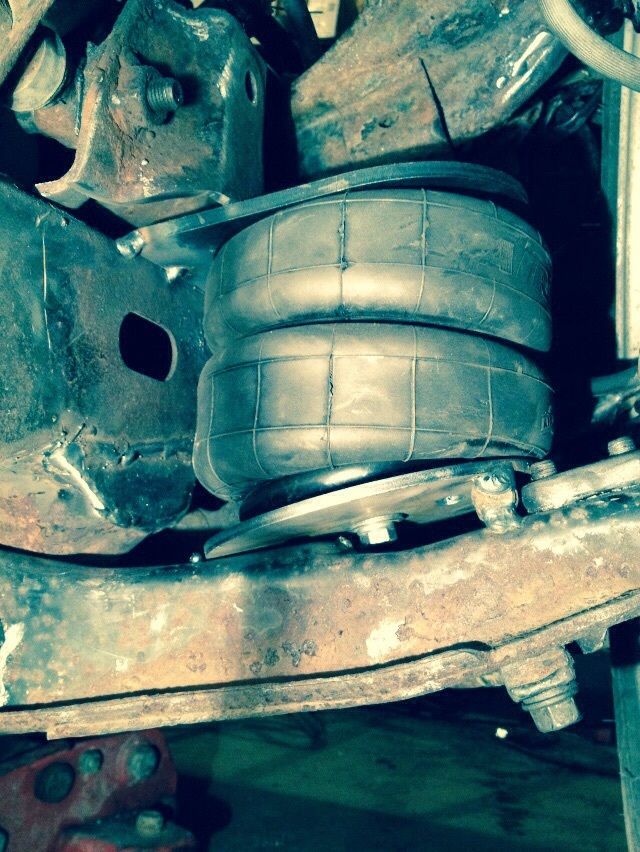

i have tacked my front plates in and need some help with the placement of them. From the pictures you can see I put a half inch spacer block under the lower plate right beside the LBJ as close to the mounting flange and bolts. Now I think that won't work because when the bag is deflated it sits at a crazy angle in relation to the top plate. The other pic show the truck jacked up a bit to simulate ride height and it is riding a little better.
Should I remove the lower mount and move it toward the wheel more and cover the first set of LBJ bolts, that way the bag won't want to pull in towards the frame at the bottom as bad? If I shorten the upper plate I loose all my clearance around the bag(I don't really want to notch the frame)
I am 2 inches away from having the frame onto the ground, keep in mind the tires on the truck are a 50 series/ my other rims are being machined and I will be putting on 40series rubber. I can trim some more out of the inner fenders to hopefully get another inch there.

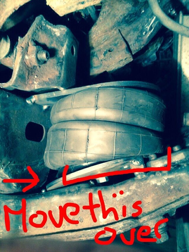

I haven't completed trimming the inner fenders. I have cut a bunch out but still need to trim a bit more out. The tires are resting on the inner fender and I have 50 series on the truck. They will be swapped out to 40's when I get my other rims back. I don't think I will have a problem laying frame after that is taken care of, my problem is the lower bag mount plate. From my pictures I think moving the lower plate "outwards" toward the tire so it covers the first bolts of the LBJ would be a good idea. Then with the bag compressed it should collapse straight- not all cockeyed the way it is now. The LBJ bolts are a little long so I will add some washers on the bottom so they won't stick up past the mounting flange. That way I can rest the bag plate on the LBJ( maybe run a 1mm space between in case I ever need to remove and replace the BJ.)
sincitylocal's avatar
sincitylocal
Yes, the lower plate needs to move out. If you're worried about the ball joint, build a bracket that raises the lower plate off the arm a bit.
