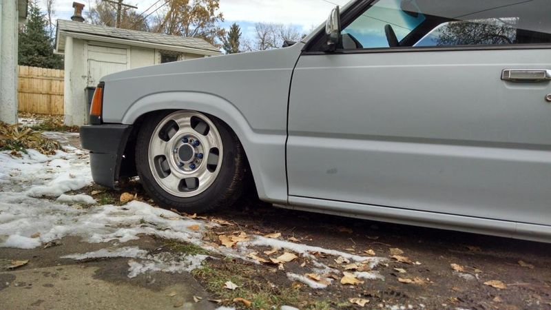

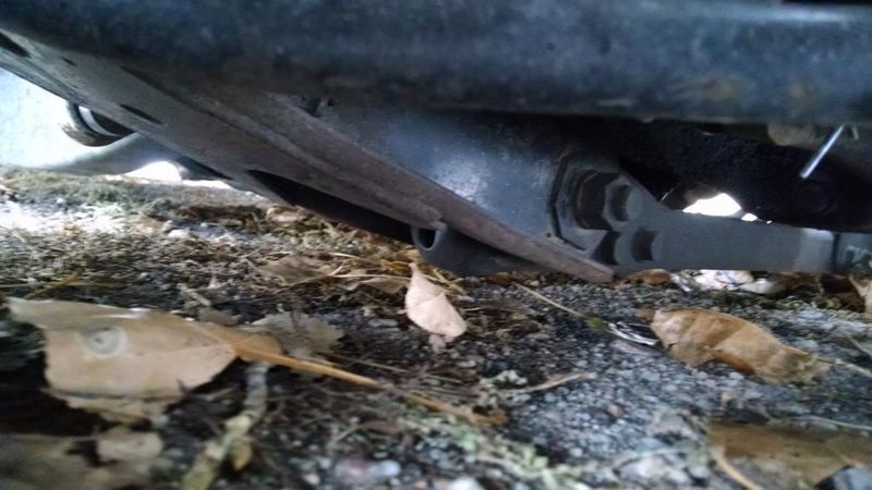

well i must have some weird control arms or something then....i dont touch the body or fenders anywhere. the lower control arm is bottomed out against the crossmember...pics are completely aired out

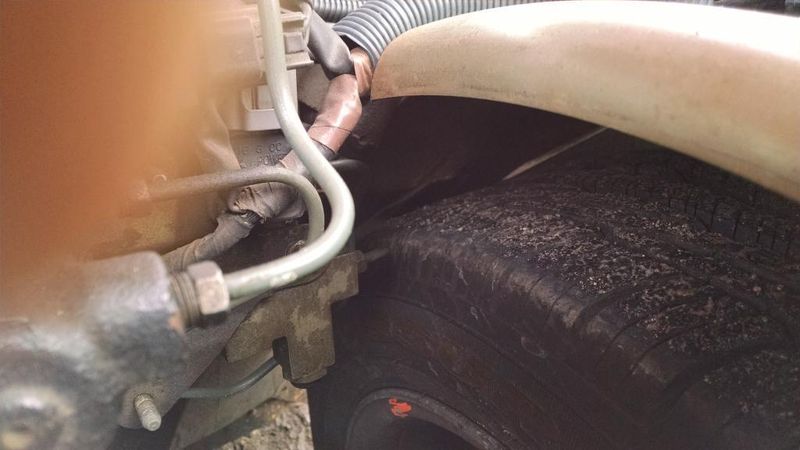

decent clearance at the firewall for now
side view rim is starting to tuck
im not trying to argue or anything....by everything ive read it should lay....ugghhh

Notch out the frame where its hitting. Thats pretty normal

i may do that....i left room for a little more flex before the bag bottoms out...shock too...weather is good for a few more days i may have time to do it really soon...i need to move my fenders at the same time if its going lower about 1/2" clearance in a few places right now...i bolted them in so i could move them if needed luckily

Yeah you gotta trim that part to make sure it doesnt hit the lower. Thats your problem
