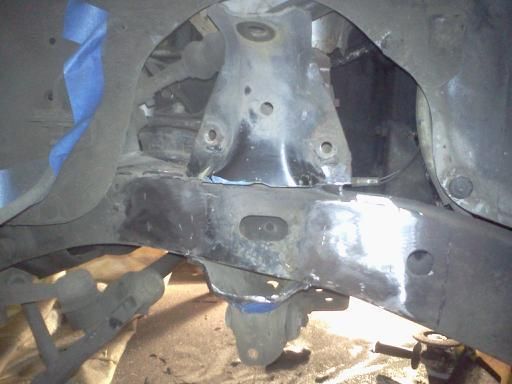

Ok here I am sofar. That cutting a grinding takes a while to get it down to frame. Tonight I should be making the filler plate for the lower cross member that I sectioned out.

Did you put the arms and spindle back on to make sure you will get enough travel on the lower control arm before you weld the crossmember filler in place? And it was a tedious job cutting and grinding the crap off the frame, luckily I have a torch and cut most of it out that way.

I did put the lower arm on and attach the trailing arm, and went through the motion up and down. I still need to notch the lower arm. I would think I should weld the cross member filler on before cutting the lower arm so I can see what all I need to clear. Or do you cut more out of the cross member out then just the frame-flush part?
mazdizzle
I cut mine about 1/4 inch past the frame, filled it in then cut out the lower control arm

Thats where I am at sofar. I cut it back the thickness of the bag plate, so when I weld the filler plate in, it will be flush with the frame.
mazdizzle
I put my filler piece inside the cross member so i still have 1/4 inch from the frame
