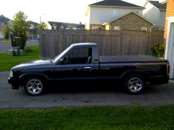

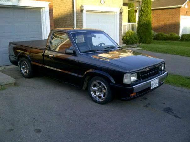

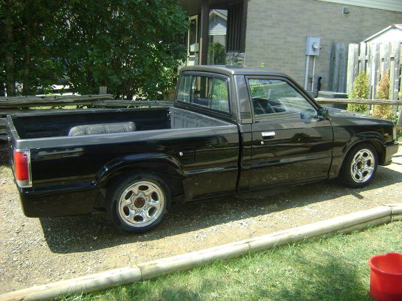

Picked me up a 91 b2200, i payed way too much for it but i wanted one asap (1 grand, needs floors, rockers, roll pan, mechanically good shape, sort of). Eitherway i love the truck, new project since ive wrapped up the latest phase of my fox notch and need something to get diry with. and i LOVE the fuel savings, 16L/100 of high octane fuel in the stang was getting real old.
first off-heres some pics
