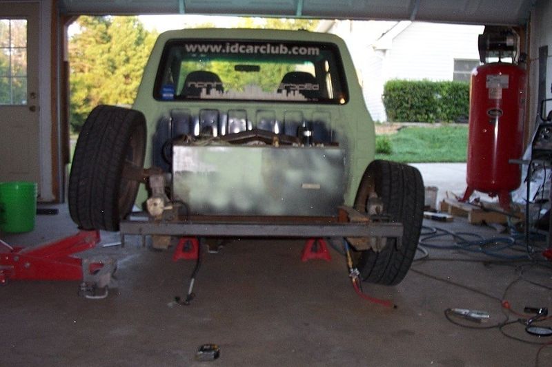

You will get the benefits of the 4 link, for doing sides add a Johnny-joint by Currie enterprises end link to the 3 link where it mounds to the axle. Trust me those end links give you a lot of flex. I need to dig up some pics I took.
Found it, this is really old from 2004 LOL
This is to show flex, I never hooked up valves to do side to side so to get this much side to side is possible with enough PSI.
