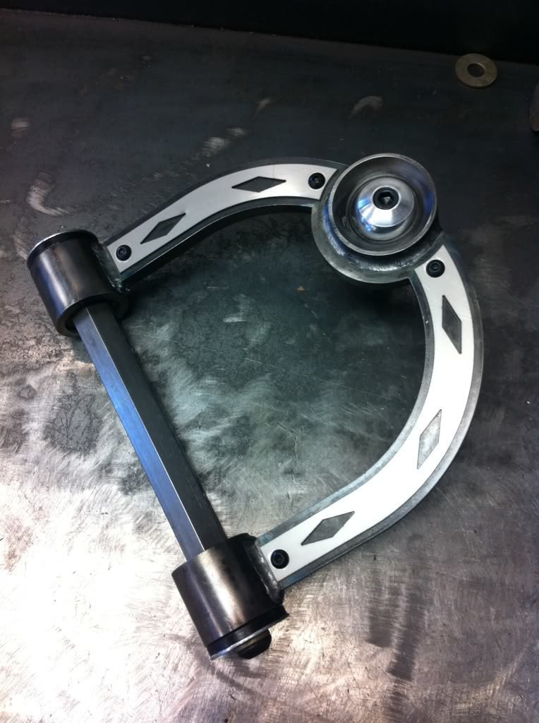

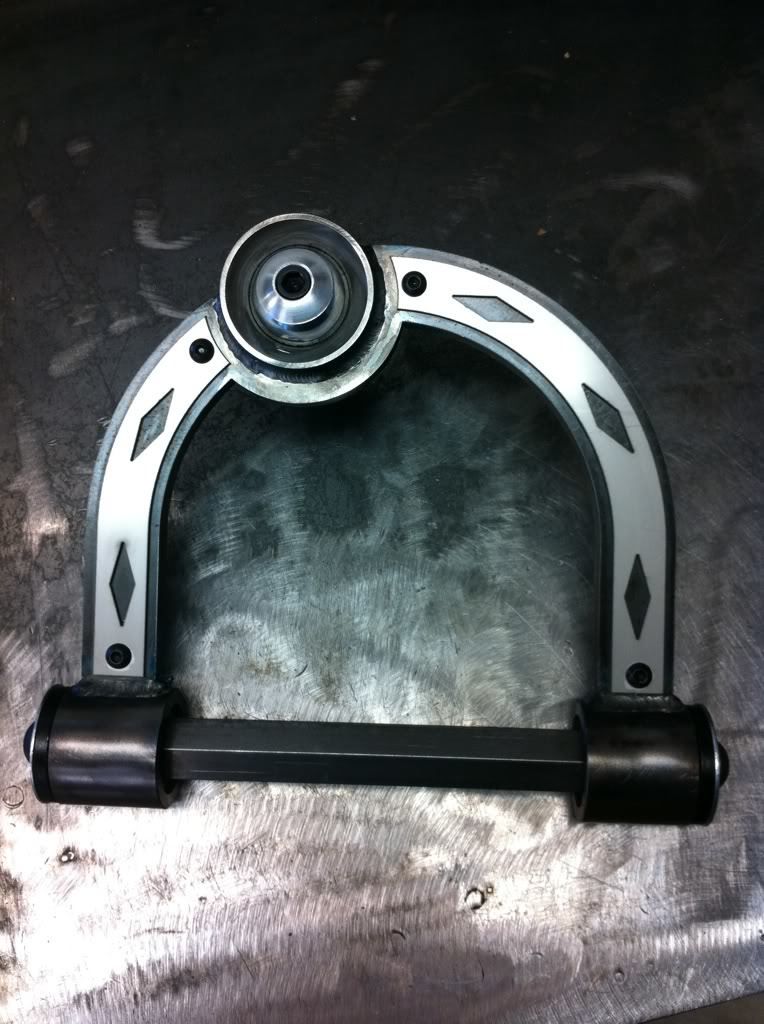

Just a pic of a mazda set i just built. Converted to toyota taper, and with a little bit of stainless trim to them.
hunterw's avatar
hunterw
haha i like your name. jeebus christ those are good lookin arms

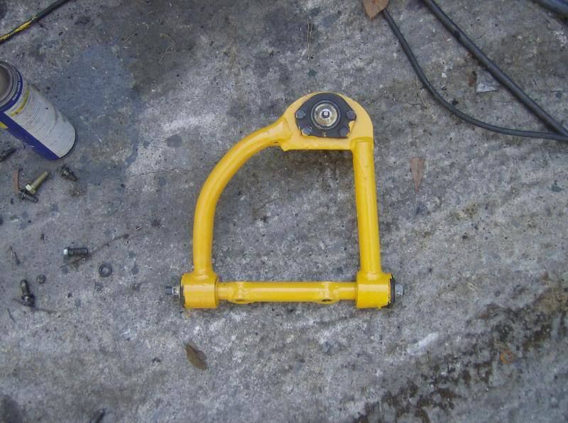

Chris, your arms look like they would work with Ridetech airshocks, as the upper arm has a full curve on both sides.
I bought a tube kit from Dallas and they wouldn't work with the Ridetech setup until I did some major fabrication to them.
Here is one stock you can see how one tube has a hard angle, this is where it will interfere with the top of the RT shock.
Here is my modded arm.
