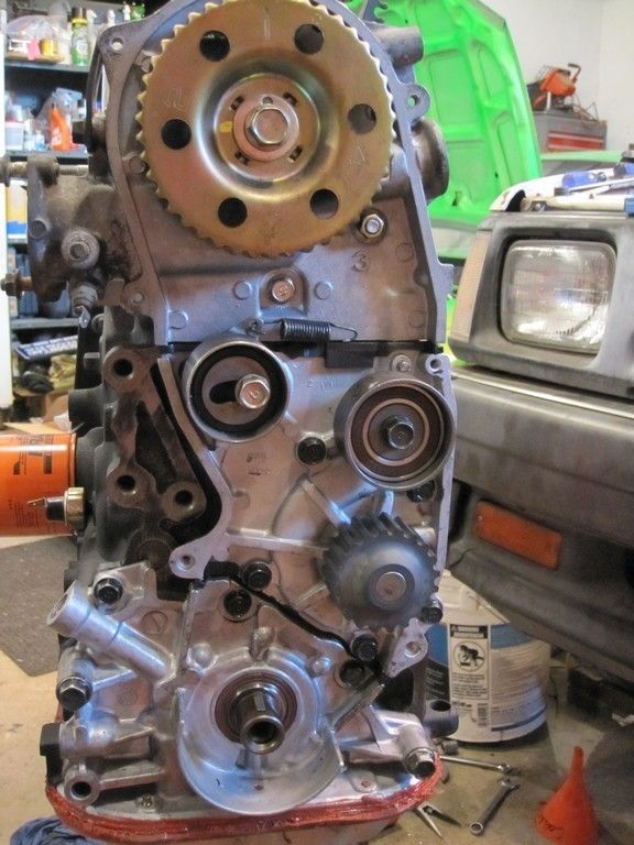

Count the teeth on the timing belt you want to replace. You will need a belt with the same number of teeth. 108 tooth belt is what the 83 Honda prelude uses. This is what mine looks like.
Post was last edited on Jul 12, 2016 06:07. Edited 2 times.

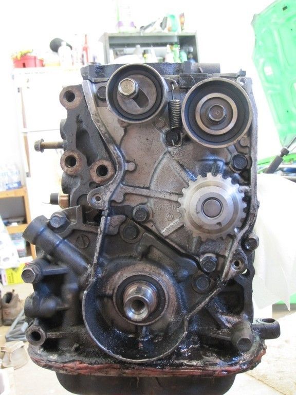

Here is what mine looks like

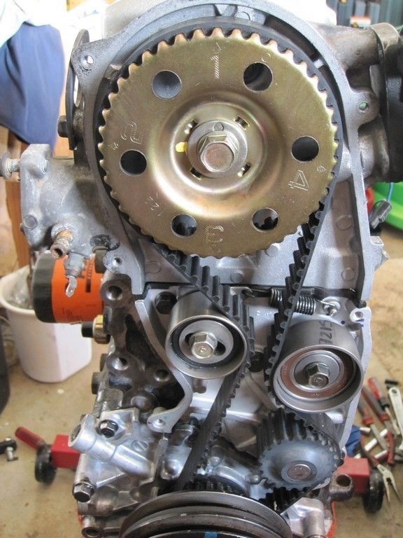

Another pic
