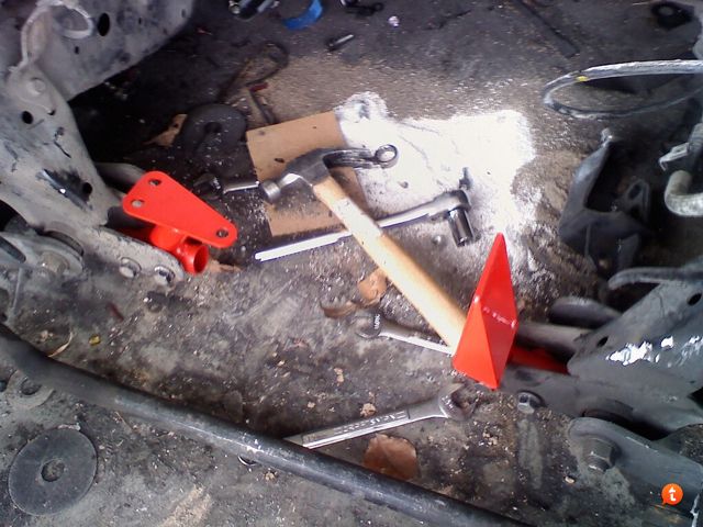

I did a 12A n/a swap before (years ago) and the engine mount was 100% custom made. This does not mean that there is not one out there for you but it is in the front of the engine far enough that renders your stock location useless.
Here is a link to a sketch...
The plate on the center was 5/16 thick welded to the cross pipe. The cross pipe had two holes to allow a bolt on each end. The angles that are welded to the frame have a thru hole to accept the bolt and a nut on the underside welded to accept the bolts.

Do you have a picture of what the mounts will look like? can you point me to someone that can make this mounts for me?

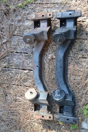

another way if you can find them at wreckers yards
s1 or s3 rx7 crossmember, I have done plenty of conversions using these where they have been near enough to bolting in with minimal modification required (slotting the holes to bolt them in or just straight welding them in because they happened to fit in the width.
If you use the factory crossmember above you then just need this front bracket off a s1-s3 rx7

I used mostly all S4 parts. I used a 91 Convertible transmission, changed the tail shaft housing and shift linkage to use the stock B2200 tail shaft and transmission mount. Mounted that up, then dangled the engine in the middle of the frame with transmission bolted like stock. The middle iron, which is where the stock engine mount attaches to the 13B lines up perfectly with the removable cross member on the B2200, so I attached it to the cross member mounts, and made a custom cross memeber to clear the oil pan (which sits lower than the stock motor), sat the motor as low as I could. Engine is solid mounted. How you mount your transmission makes a big difference. The clutch release arm is on the top drivers side, and had clearance issues, however, the oilpan cutout for the frame is very close to the steering on the B2200, if I were to move my engine forward 1/2 inch, it would have to be 2 inches higher to clear the steering. Also, my motor is very tight to the firewall, so you could not really move it backwards much further.

Do you have any pictures of your setup, how you mounted the engine and the the crossmember you made?
