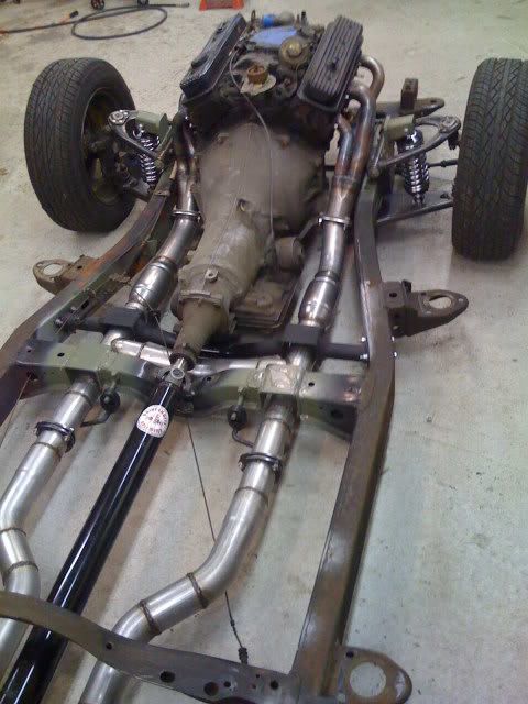

crossmember: you can mod the stock, i bought a universal trans mount, $39 make it work. simpler, cleaner, made to fit your application. heres mine in the chassis
engine position: yes, far back as possible. i clipped the lip so i can get my fingers around the cap

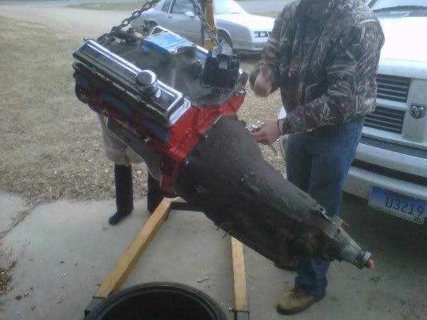

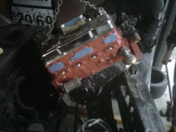

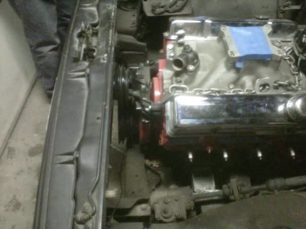

Yesterday i got the motor bolted up to the th350 and bolted in. The motor mounts are solid mounts i made. I did not modify the tranny tunnel at all and this is as far back as i could get the motor. The distributor is about 2" from the firewall, and the oil pan is just barely off of the crossmember. The transmission crossmember has 2 mounting holes and there are 3 mounting holes on the frame to allow 2 different ways to bolt in the xmember. I moved it up to the closest 2 mounting holes and it made the holes in the tranny mount line up perfectly with the crossmemberr mounting location. Exhaust is going to be very tight but should be doable. Biggest problem i see is where am i gona put a radiator and fans??? I can get a short water pump but i still have hardly any room up front!!! All in all the swap was very easy, you can buy or make universal mounts, tranny lined up great, and didnt have to remove any of the front clip.

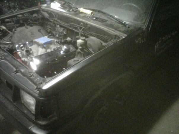

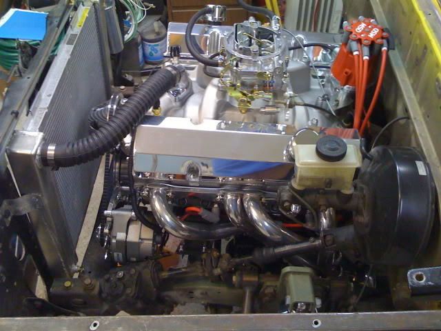

i too did a sbc swap in mine...i didnt buy anything...made all my mounts and used the stock tranny crossmember....its still in the very rough stages but fuctional. Heres what i got for pics so far...i figure a link is better than trying to post them all.
jc50942
everything fits really tight up front and i put in fans right behid the grill.
