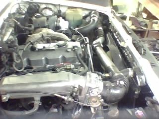

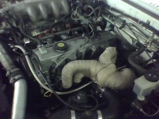

The engine bay looks like this.I'm running 9psi boost, a Saab intercooler(mayhaps a little small)but it runs
really sweet,is giving me about 20 to 24 mpg,more if I'm not boostin Gimpy

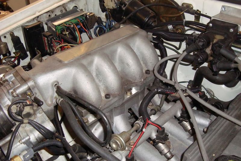

A pic of the intake &amp; adapter

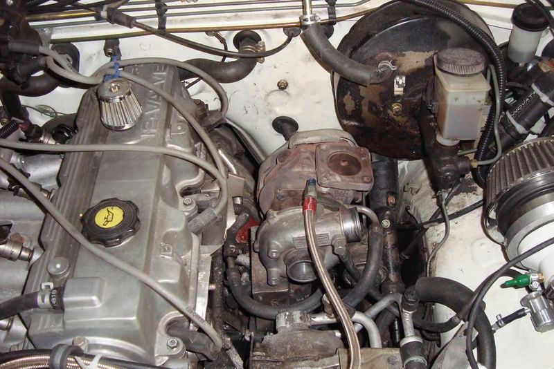

a shot of the turbo without the manifold in the way.

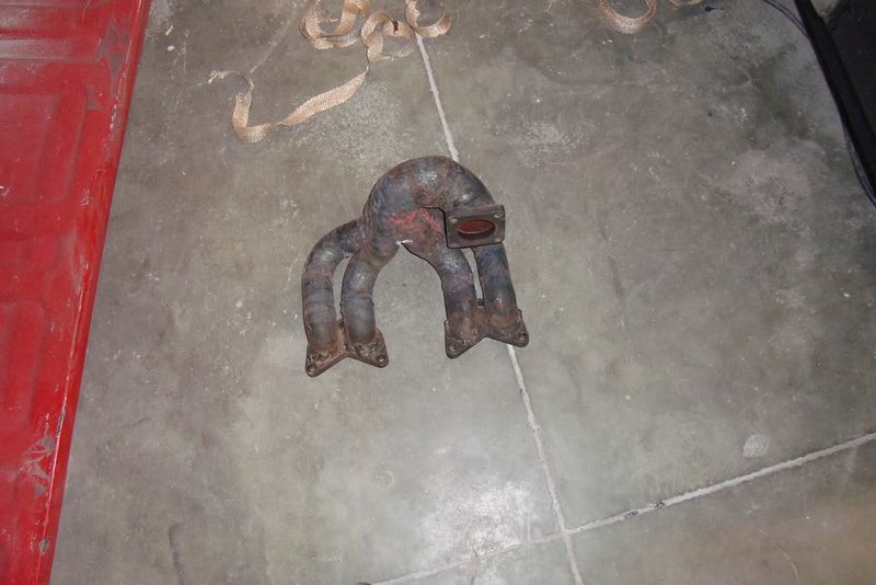

A shot of the naked manifold(developed a crack at the collecter part on the inside radius)I'll have to take the dog to work with me &amp; weld the overcooked dog back up.Gimpy
