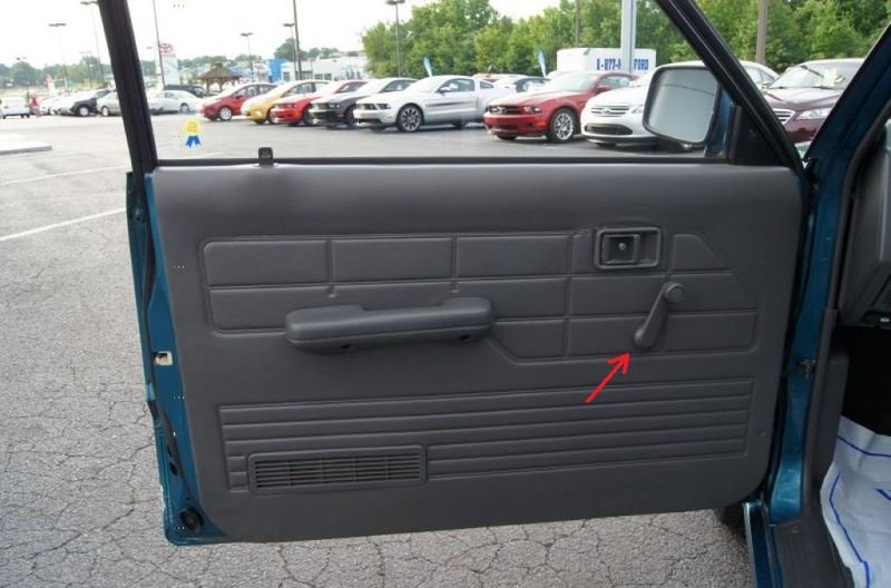

Start out by rolling the window down and removing all of the screws...
Go ahead and remove the little black piece behind mirror.
Then there is a little metal clip that holds on the window crank that is between the crank and door panel. They make a tool for this also but you can use a flathead to push it out just don't lose it haha.
Then start at the top corner near the hinges and begin popping the push fasteners loose. These are the ones SinCityLocal suggested the tool for. Be careful not to break them or mess up your door panel itself. Once you have them loose all the way around pull the bottom of the door panel out and fish your interior door handle through the hole. Then just hold out a little on the bottom and lift it straight up out of the window channel. Just reverse everything to put it back but be sure to get the lock plunger back in its hole at the rear corner of the window. A tip for putting the window crank back on is to put the metal clip on the crank and put the bushing in place then just push it on it's shaft and it should lock into place.

You're very welcome and I'll help all I can. I forgot to mention the plastic clip on the door handle itself but it's pretty self explanatory once you get the door panel out of the way and can see it.

The panels don't have to come off to remove or replace any of the door handles or window cranks.

1) You need to make sure which direction the clip was installed because some people have them installed so the ends of the clip face away from the handle.
2) Yes, you can easily change the handle without taking the door panel off - in fact you have to remove the handle to remove the door panel.
Take off the one phillips screw, pull the rod so you can access the clip that holds the rod - then unclip it.
Takes no more than a couple minutes once you know what to do.
