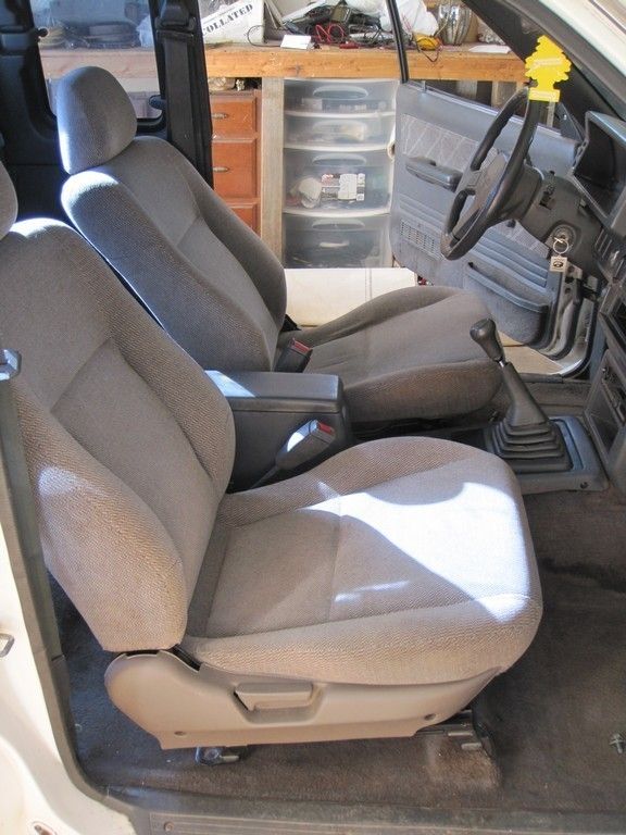

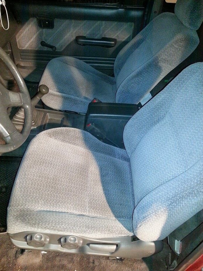

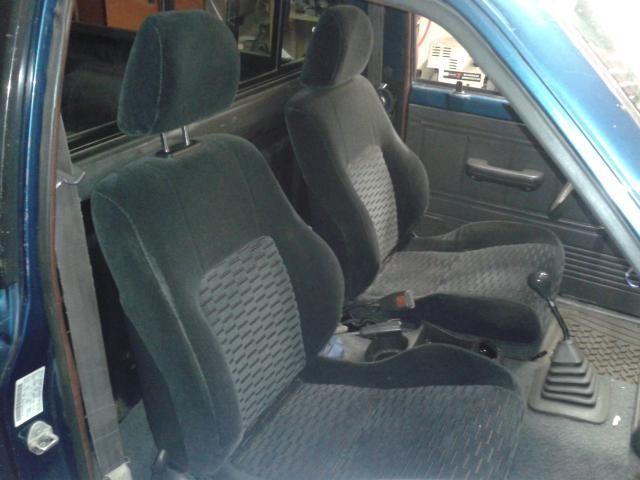

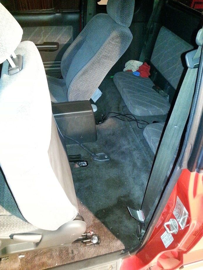

Glad you found a solution!! I would use grade 8 bolts. I had a bolt break for my seat when I was in a head on collision. I saw that civic seats would go in with bending the one tab. I sized up the stock seats from my 96 civic in my truck. I didn't want to drill holes, so I will modify brackets when I put them in.
Here is what they look like sitting in the cab.

Here are the pictures...

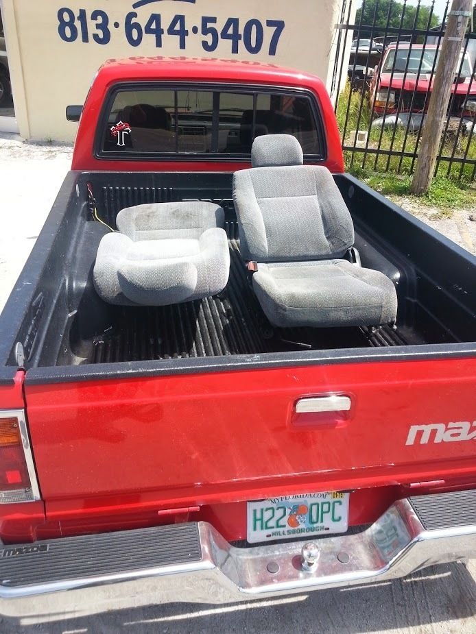

At the junk yard

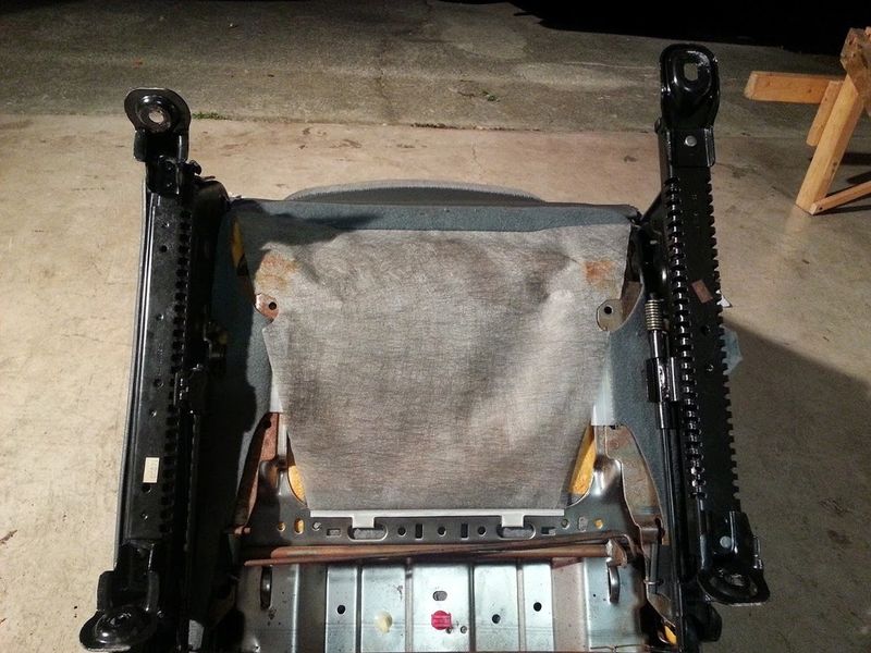

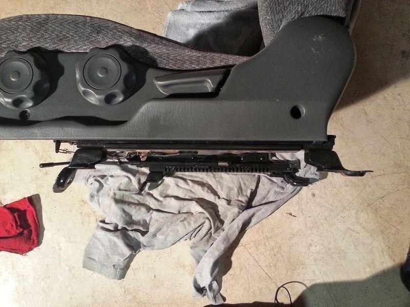

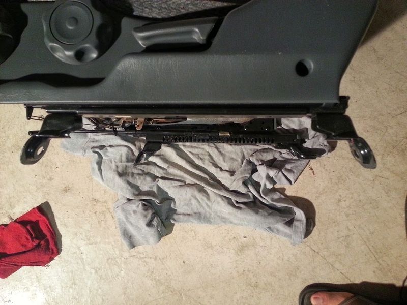

driver side bottom. At the top left hand corner you can the the tab that needs to be "modified"
before modification
after modification

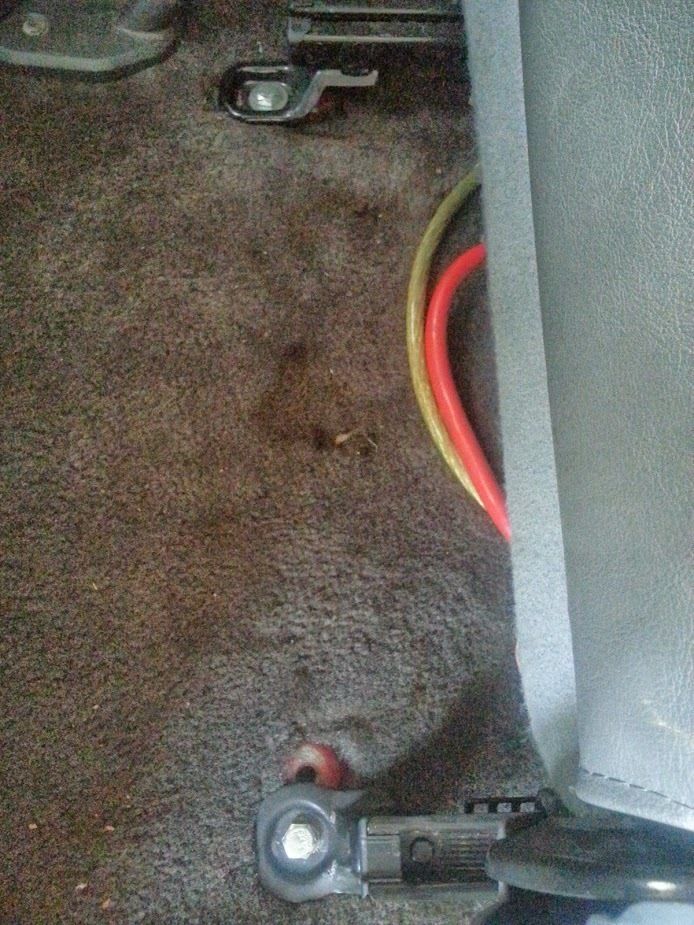

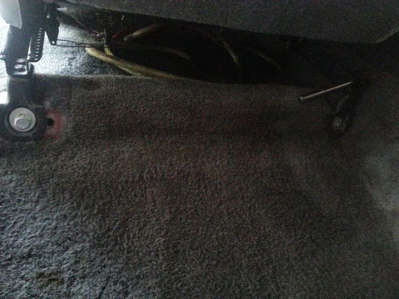

One (1) new hole for passenger side
two (2) new holes on the back

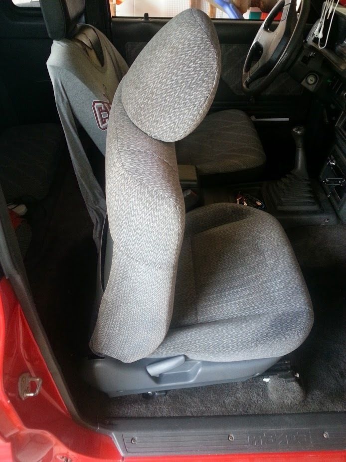

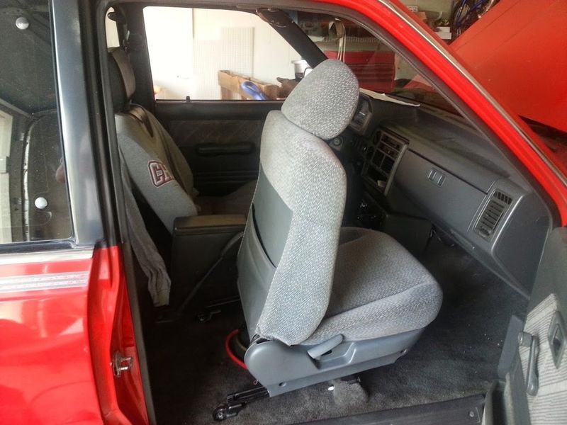

passenger side done
passenger side all the way forward
driver side done (too dark for pictures)
diver side all the way forward
If you have any questions feel free to ask away.
I hope this helps.
