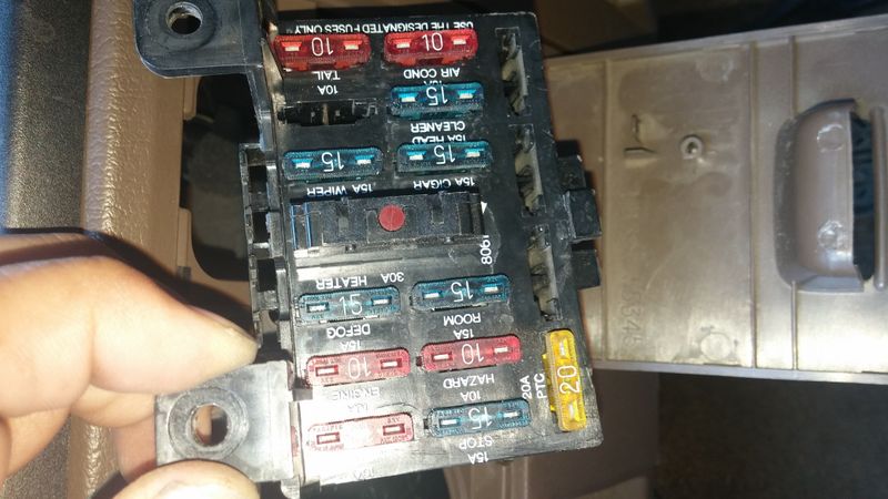

This is what i have. Now when i checked the "Room" circuit with a volt meter it reads -12v dc with the key off and on. I found that the circuit with the defog fuse switches from 0 to -12v dc (thats off then on) so would it be ideal to tap into one of those?
Post was last edited on Feb 26, 2017 06:53. Edited 1 time.
Cusser's avatar
Cusser
Before that, try head cleaner fuse (that was for a cassette player, sounds like a good stereo tap in) or wiper fuse. Correct, needs to be off and on like the defog one.

So I finally got my radio to power on with the ignition. I just tapped into the cigar fuse with a fuse tap. Works perfectly fine now. Thanks! Now on to other issues.
