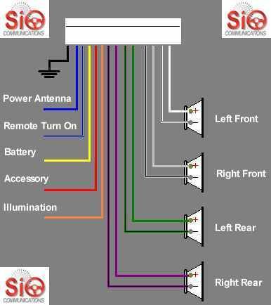

Here's what I used to do my wiring
Essentially all you need is the accessory and battery wire along with ground then if you have an amp it hooks to the remote on wire and the rest is just speaker wires. Does your wiring colors March those in the pic?

its all the same, minus a ground wire. its the first ive seen like that. installed several other cd players with no issues(in fact most of my friends/family come to me to install theirs), but they all had ground wires. i dont like that this one doesnt have that. but aside from that its a VERY good one. pictures may clear it up, and ill get them up first thing in the morning.
