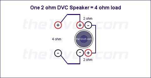

for the dual 2ohm sub you would take the voice coils as coil A and coil B. take the neg of coil A and run it to the pos of coil B. that leaves you with an open pos (coil A) and a neg (coil B). those are your speaker leads. that runs the sub at a 4ohm load. then take them to the amp and bridge the amp to a 4ohm load which usually has a diagram on the side of the amp. take the pos off the speaker and run it to channel 1's pos then take the speakers neg and run it to channel 2's neg. thats it buddy.

say i get the DVC alpine type s 2 ohm sub (SWS-1023D ). i'd run one pos and one neg wire into the box and wire it like this since the alpine amp puts out 160 x 1 at 4 ohms and that type s is 50 - 300W RMS. for that 160 x 1 rating is that rms or peak do you suppose?

Sounds like you got it!
The Alpine appears to be 160Watts RMS. They don't list peak I believe.
