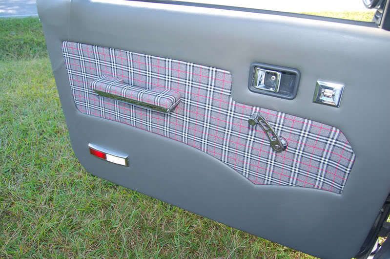

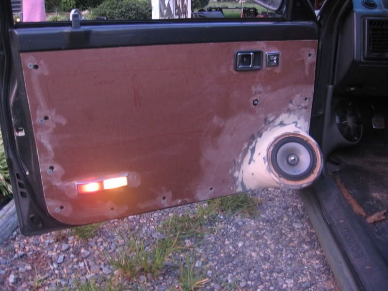

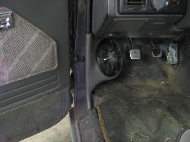

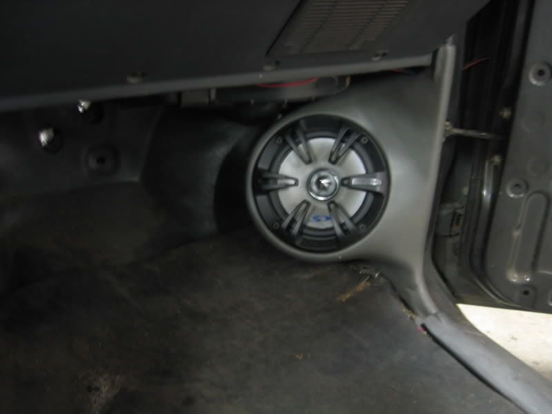

ok so it was slow again at work so i started doing my door panels. figured id give it a shot since everyone else was doing theres. first pics are of my kick panels i just done last week.

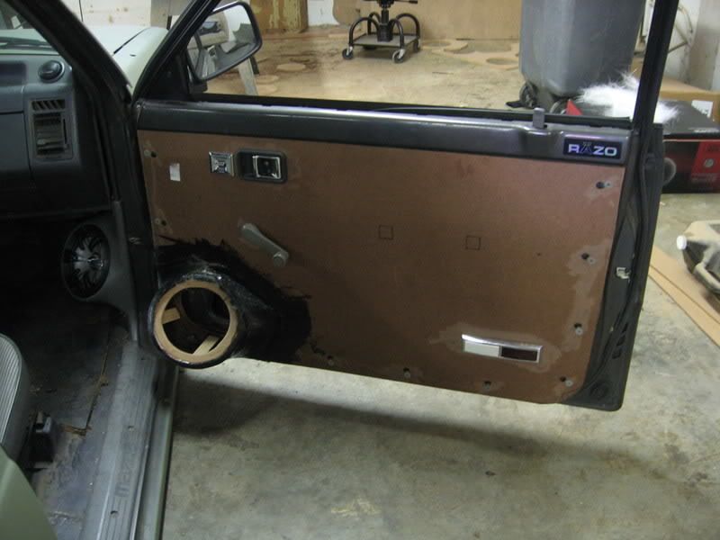

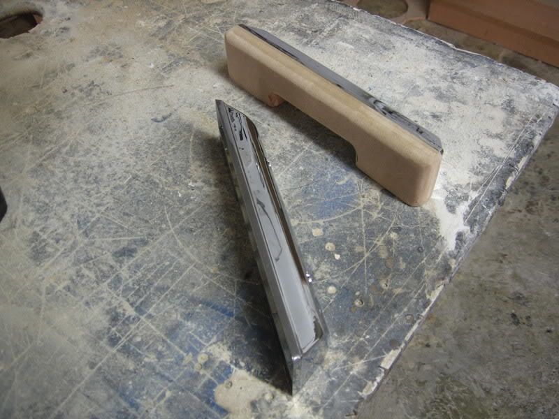

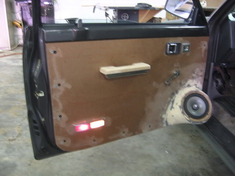

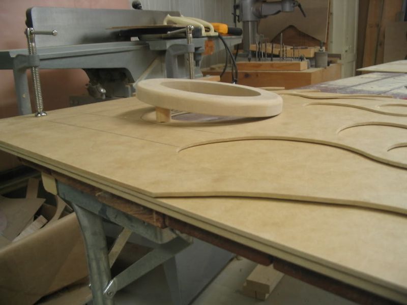

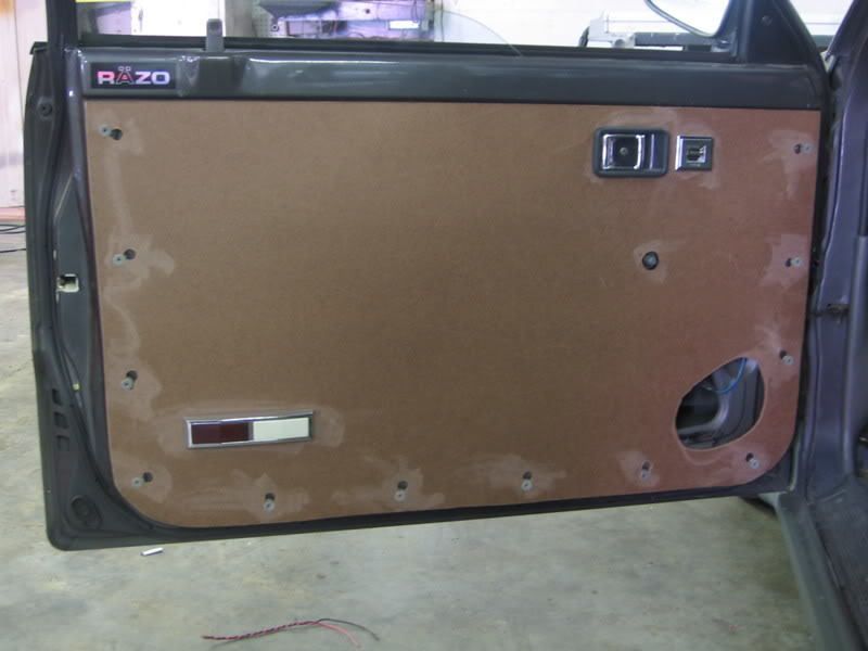

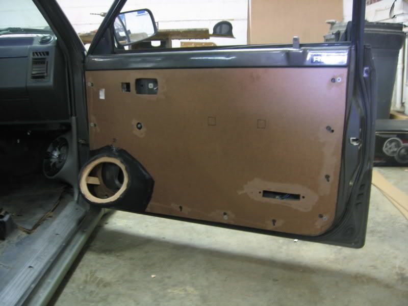

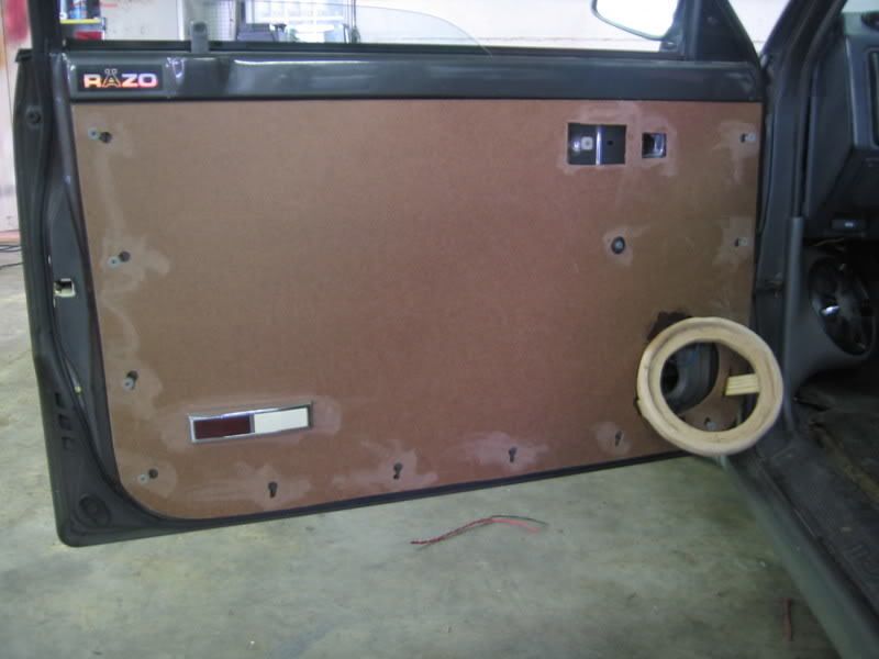

ok heres the door panel. didnt think about taking pics till i already had the thing test fitted. i started out with some 1/8inch wood from home depot. cut it and made clip holes and such. i also added some courtesy lights from an old cadillac.

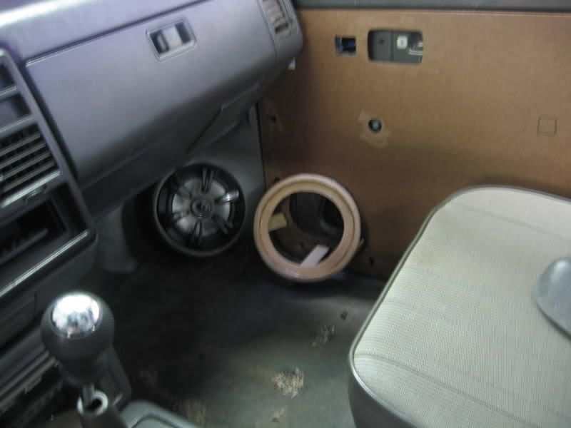

the hole had to be cut to clearance for the speaker. heres the speaker ring mounted on the door.
heres the pass door shut with the ring on

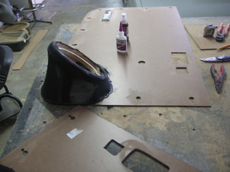

so then i took some speaker grille cloth and stretched it and glued it with some ca glue

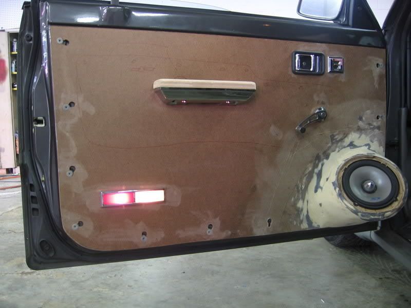

here it is mounted

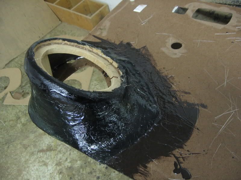

then i put some resin on it and some fiberglass mat
thats all i got so far. more to come. let me know whatcha think guys

Lookin good. Kick panels look like they came out really nice.

lookin good man!
what are those switches beside the doorlatches?
Post was last edited on Jul 30, 2008 02:52. Edited 1 time.
hex0rz
Sheesh, I'd pay you to do mine!
Just it seems they stick out so far?
91b2200(cody)'s avatar
91b2200(cody)
prolly power windows or door locks
Post was last edited on Jul 30, 2008 02:59. Edited 1 time.
mazdawg(mikey)'s avatar
mazdawg(mikey)
my power door locks
mazdawg(mikey)
yeah they stick out a bit. gotta watch those ankles....lol
