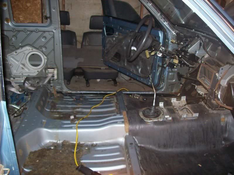

I'm having trouble getting the drivers side bolt on top by the windshield out, i have the other 2 on top off and the 2 underneath and the 2 on the sides and the 2 inside the glove box so i think this is the last one. The steering wheel is dropped already how am i suppose to get it out? Im so confused and fustrated im about to kick my windshield out

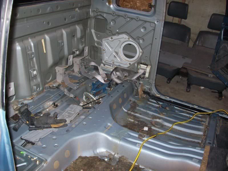

I got it out last night woohoo! i got the carpet and the headliner out today My pink carpet should be here Wednesday

from the pics,your truck is in a garage. You're right. Lazy.
