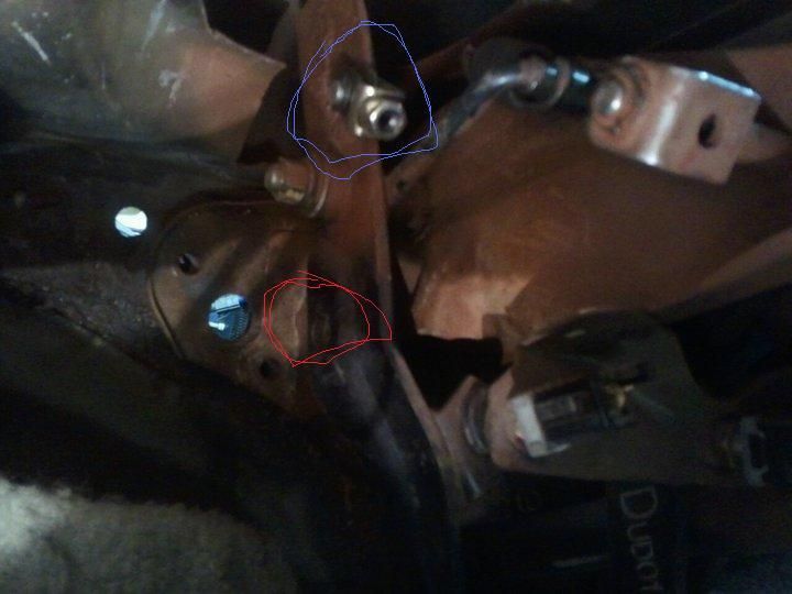

i relocated the clutch master cylinder inside the cab... but it seems like the push rod doesnt get anywhere near the same amount of travel compared tobeing where it was... any help?? i did not modify the clutch pedal location..

red is the old push rod location...blue is where i relocated it too

the distance from the pivot point is now shorter then it was before thus giving you less movement.
bagdb2200
Exactly what he said. Measure how far down the factory hole was and make the new one that same distance.

10 four fellas...figured that was the problem but didnt think 1/4 inch of travel wud matter... what if i go a little further away from the pivot then factory? wud there be any drawbacks to having more travel than factory?
bagdb2200
It would probably damage the master cylinder if you do that.
