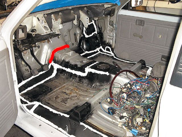

Im new on this forum and have been through a lot of threads about BD, but still got one question..
Im bodydropping my cab according to Minitruckin
cause it wont line up it the tunnel would be higher
solow
Ah i see... its for making the interior fit again ?
no the tunnel would raise above the cut you couldnt weld it back together
solow
Okay.. and there is no transmission trouble like that ??
ur2nvs
A guy on here did that right up i do beleive.. maybe he will chime in.
hunterw
Its also cut like that to make room for your heater core. If you cut it at the red you won't fit your heater core back in
hunterw
Cut mine different ias I don't have a heatercore lol. Check my buildlog
solow
Thx guys.. i will do it as MT suggest, here in cold Denmark i dont want to leave out the heatercore
