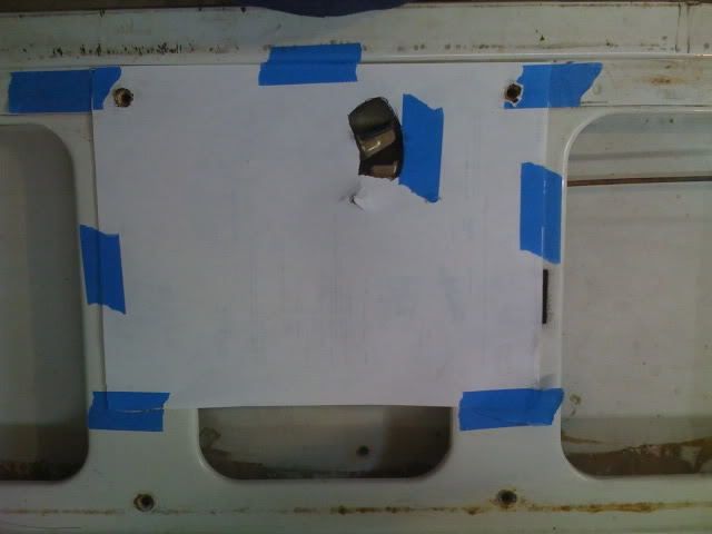

Has anyone just filled in the bumper bracket holes in the rear valance of your trucks.

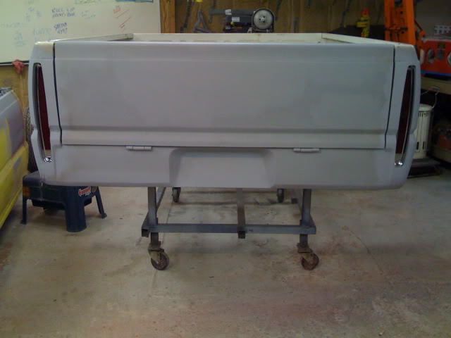

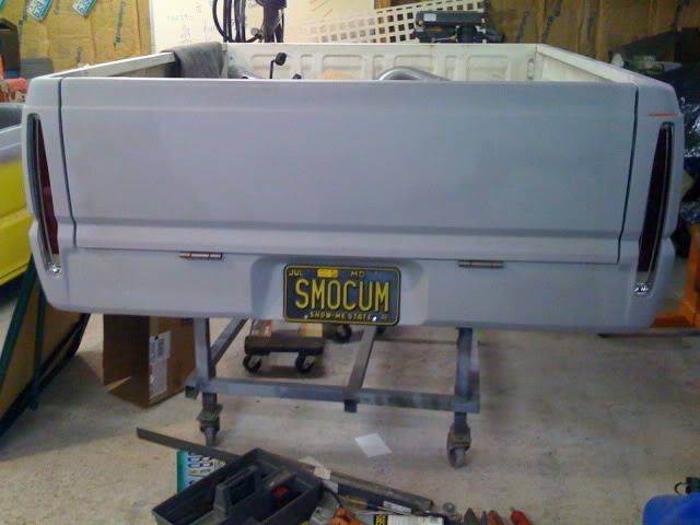

here's mine. i also pinched the tag box to fit the plate
mazdawg(mikey)'s avatar
mazdawg(mikey)
Bobs is super hott!

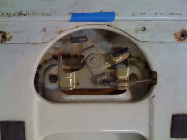

bob just wondering do you have a tailgate handle relocater and if so where did you buy yours thanx
snoplow
elocating the handle is really simple. cut the hole around the handle, cut new hole on inside of gate, flip both the rods hookem back up weld back in. fill hole in skin
oldspice213's avatar
oldspice213
what does the kit do
snoplow
dont know. i didnt buy a kit. just did it myself. i just added like 1/2 inch around the recess and cut it out. then made the cut on the removeable inner piece and welded it in. i cant remember if i had to flip the rods end for end or swapped sides.but you have to hook those up after welding it back in and before you screw the inner back down. i made some filler plates to fill the gap where the recesses were and made it flush. then on the outside i welded my filler in. i had some 18 ga sitting around that i used.
