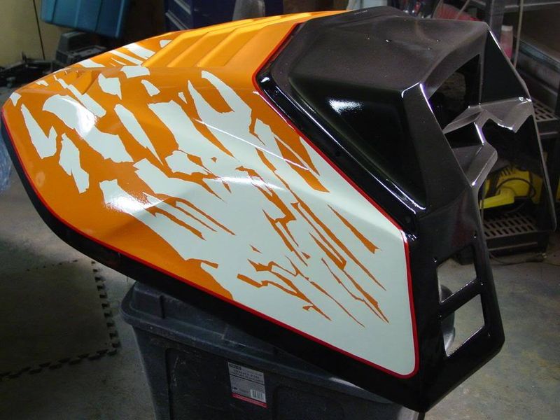

I have been fighting the dang passenger seat, so I didnt get it done then I was busy with family holiday stuff and a painting side job
mazdadropped
nice what sleds that off
mazdamandan's avatar
mazdamandan
paint is on a late 70's El Tigre Arctic cat
