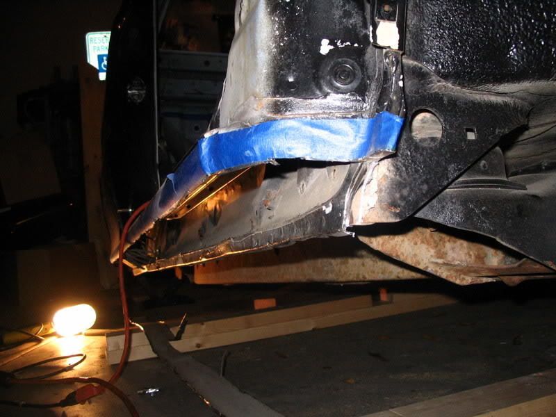

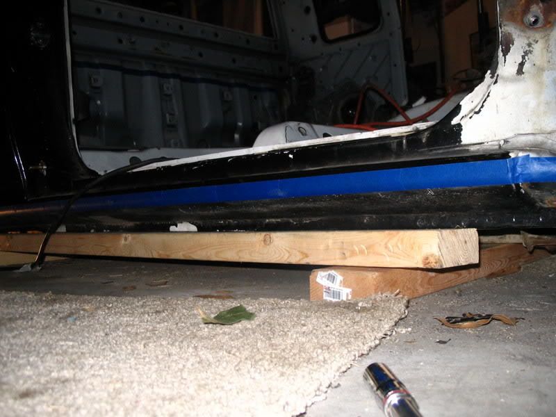

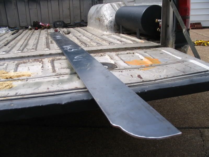

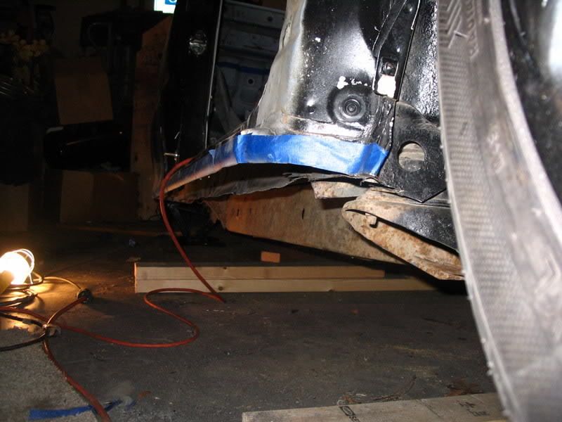

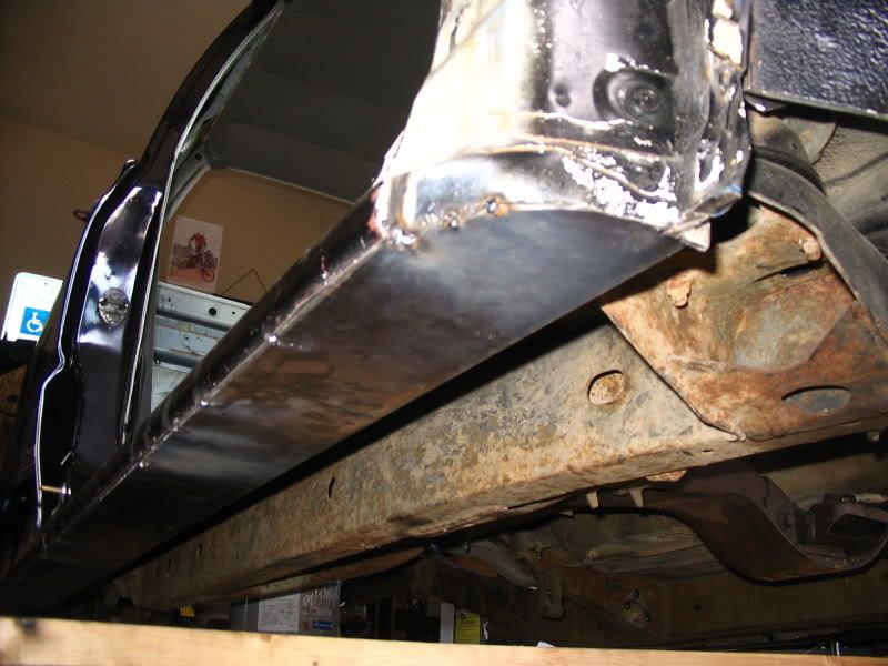

Ya man. . Do like me. . I bodied mine an inch into the rocker. . so 3.25" total bodydrop. . I cut the whole backside of the rocker out so my new rockers would fit in. . and once I finish the rockers, I plan on runnin sheetmetal from the rockers i made, to the bottom of the cab. . So you could jus bodydrop it more so you cut out most of the rusted parts. . But the more you bd it, the harder it gets. . or you could jus bd it to the rocker and cut out the rusted part and weld in new sheetmetal. . The part by the gas pedals shouldnt be a problem. . jus cut out the spot of rust, about an inch bigger than the rust, and make fillers. . no big deal. .
heres some in progress pics of how i did my rockers so far. . .
And thats pretty much how it sits as of right now. . . . I am a fag and havent touched it in 4 months so nothin else has gotten done to it. . . . . But dont worry too much bout tohe rust dude! ! ! Anything can be fixed. . . Jus whether its worth it to you to fix it or not. . or jus get a new cab and start on that one. . .
