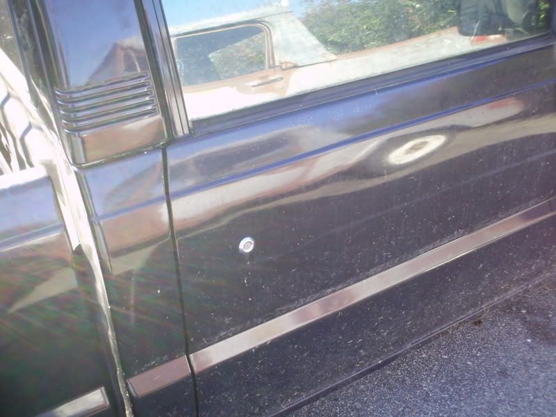

I welded the doors on my car and it still cracked when some stupid bitch hip checked it to close the door. SO MAD!

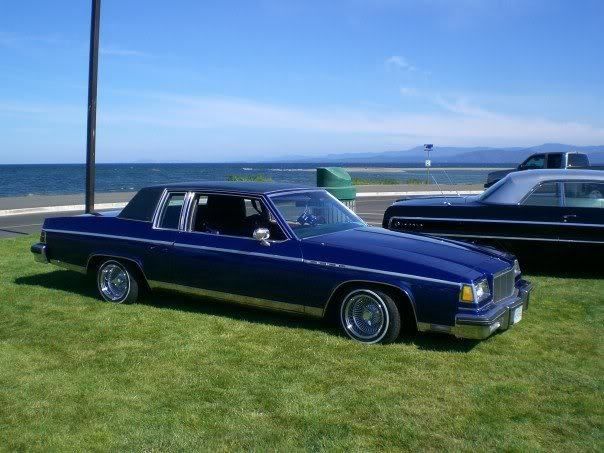

The ones on my 87 were done over 8 years ago and still no cracks.
lowered_impressions
Yeah problem was the stainless trim on the side of my car. When she hip checked it all the force went on that 3/4 inch strip right above where the door handle was. It flexed the sheet metal and cracked the small amount of filler there
