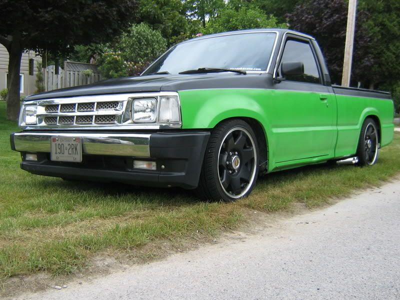

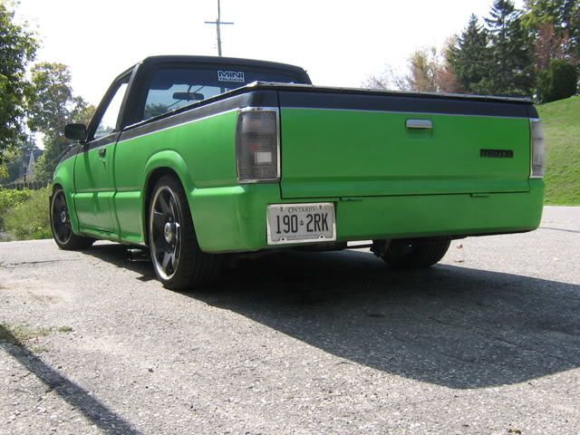

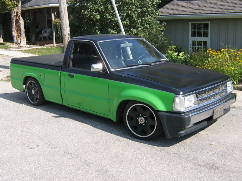

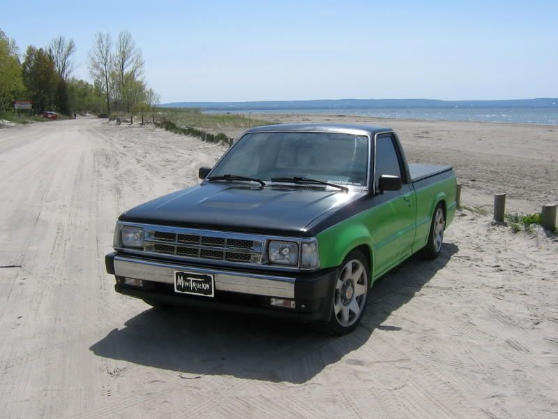

Here's a couple better shots. It took me an entire long weekend to prep,paint and finish everything,all outside in my driveway lol. I used Duplicolor Grabber Green Engine Enamel,and Duplicolor Truck,Van & SUV enamel black,and topped it off with Motomaster Clearcoat in a rattle can. I then wetsanded the truck about 3 times with 1500 grit sandpaper and put on a 1/4" grey vinyl pinstripe to seperate the colours.
These pics are all 2 to 4 months after it was painted.
This one is at he end of the weekend after I finished it
