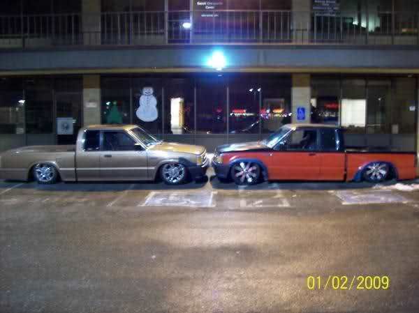

Not quite, I had to cut 3 inches off of the end of the frame rails. I removed 8 3/4" of the bed in front of the wheel wells to make it like an ext-cab bed.
porkchop69's avatar
porkchop69
I HAVE A EX CAB AND HAVE A STAND CAB BED ON IT I HAD TO CUT 9 INCHES OF THE BED AND 3 INCHES OFF THE FRAME I ONLY HAVE 4 BOLTS HOLDING THE BED IN AND THEY HAD TO BE DRILLED OUT TO FIT ITS KINDA COOL I GET LOTS OF COMMENTS BUT ITS EASIER TO JUST BUY THE RIGHT BED THE FIRST TIME
porkchop69's avatar
porkchop69
mines the one on the right
