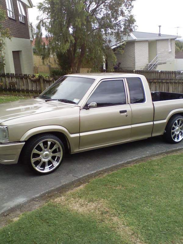

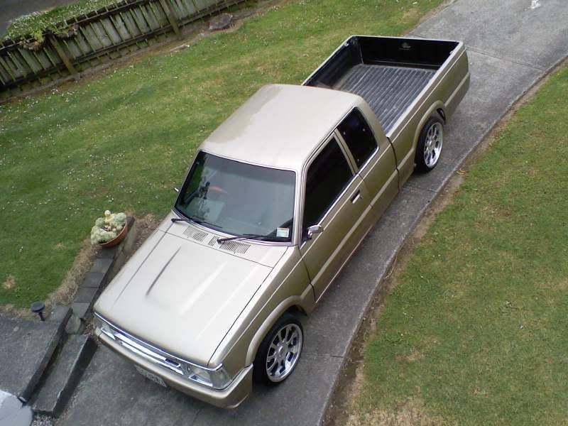

Well I got it painted on the weekend, I haven't got around to doing any polishing yet but here's what it kinda looks like now (pics are from my phone)
The color is from a Toyota, it came out fairly good and turns heads but unfortunately I had a issue with the Bondo I used, I filled some small dents around the body and it wasn't till I got the clear on but the gold reacted to it, looks like it has circular wet spots on some panels about 2" round
I've had some people say that it's barely noticeable but of course my eyes are drawn to them whenever I see it.
Guess I'll have to do a repaint in the next Christmas holidays.
lowered_impressions
Looks great man! Guess you dropped the two tone idea lol. I had the same bodo issue your talking about but for me it was where I sanded through the primer the transition between the bare metal and the primer made the funny round marks.

that color looks pretty sharp on it, definitely not the norm of color choice for our trucks

gold can be a hard color to blend and match... it looks like the door is different from the rest...
the color is nice tho. def not the norm!
dvsdev
Yeah I noticed the door too, from side on it's hardly noticable, but from some angles it shows up more.
I was getting blinded by the paint as I was doing it so it looked really mint, once I got it home again I was able to walk around it in the shade and noticed my mistakes.
