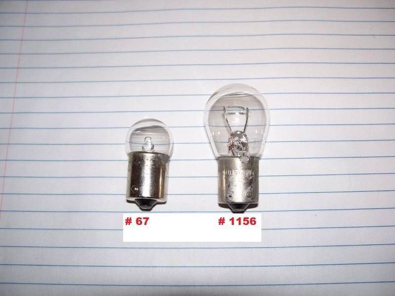

Heres a pic of the different bulbs. On the left is the #67 bulb which is what the truck should have from the factory. The 67 bulb is an 8 watt bulb, not to bright. On the right is the #1156 bulb which is a 27 watt bulb, way brighter. The 1157 bulb is basically the same as the 1156 except it has a second contact on the base because it a dual filament bulb. One filament is 8 watts and the other is 27 watts.

so THATS why i can bring a plane in with my front markers.
dragginmazda86 (dave)
^^ When I got my first mazda a long time ago it had a 67 bulb on one side and 1156 on the other. The guy I bought it from thought it had a short on the side with the 67 bulb. It looked really stupid like that.

yeah,I did it on my tails...your corners will come out the same way.
crazymikey's avatar
crazymikey
That's cool about the bulbs,I never knew the difference and that those 2 were compatible. I didn't like having the white bulbs in my clear corners,I wanted to get amber ones but couldnt find them in the 67 size.

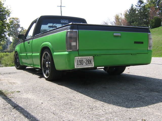

crazymikey
it's the small details that make up the big picture.
Like,did you notice the Mazda emblem on the tailgate,which is from a 2nd gen RX7 hatch,or the stock chrome centre caps on the Escalade rims,or the chrome tips sticking out infront of the wheel?
shilaeli huggr (burdaddy)
damn i just noticed your caps. one of them subtle details. they're the best. too bad my caps wont fit on my yukons.
crazymikey's avatar
crazymikey
mine only fit because my rims were bored out. They didn't snap in like on the stock wheels,they just kinda fit in snug. I ended up losing 2 of them over the course of the summer.
