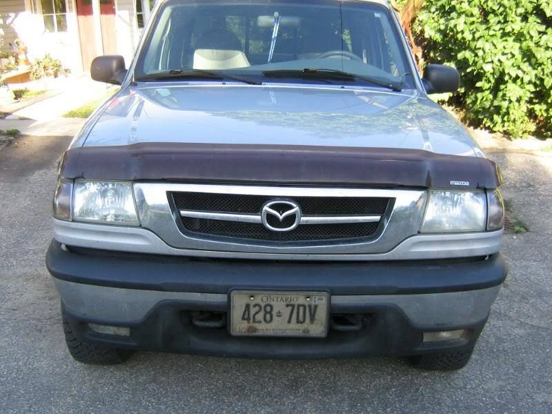

Shaving the emblem was easy. Sawzall and a bunch of bondo. The hardest part was shaving all the honeycomb crap out. I did it in an afternoon and f***ed it all up. Took me awhile to fill and fix it all. ( its my grille if thats still unclear lol)

Awesome grill! I'm wondering how long the filler is going to last before it cracks? I don't think its going to adhere well to the plastic..
How did you fasten the mesh onto the grill? I've always wanted to do it, I just don't have any idea on how to fasten the mesh!

haha "tits" .. awesome. But thanks yea. I took a spare grille off my buddy and was like hmmmm wut can i do. He to had shaved the emblem off his grille so i was doing the same but i wanted that honeycomb GONE.
And surprisingly enought that bondo is adhearing really well to the fiberglass grille.
And the mess is held on by JBkwik weld. That shit is AMAZING.

I did a similar grille insert on my '02,which is more for protection than it is cosmetics,but it helps that it looks cool too. I made it out of Gutter Guard lol.
