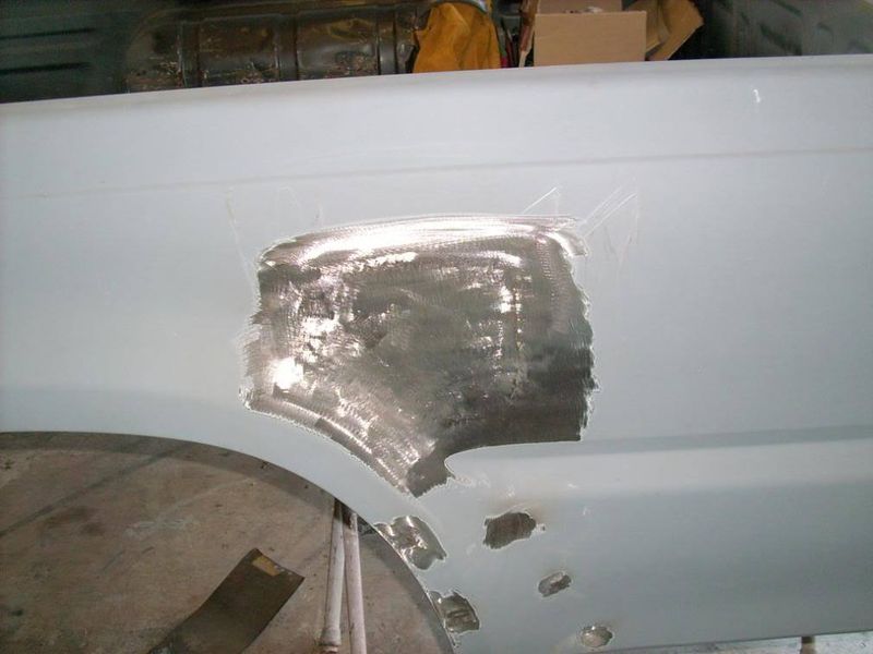

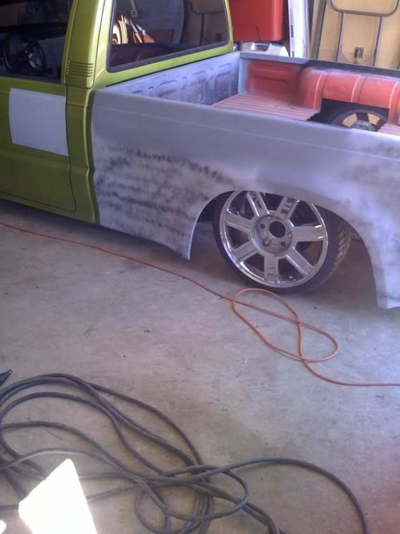

not trying to jack this thread but juicedmazda where did you get you gas door filler or did you make it yourself
juicedmazda
it was made
outkastdawg's avatar
outkastdawg
im looking for one pm me with the info on where u got it

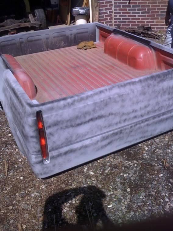

nice work juiced but were are the rest of the rasied bed floors bro.

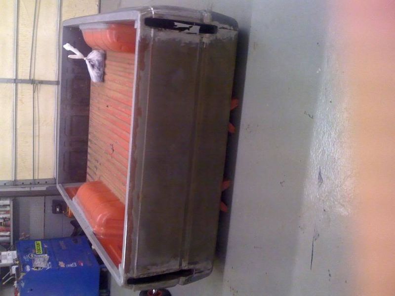

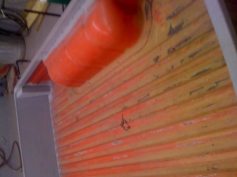

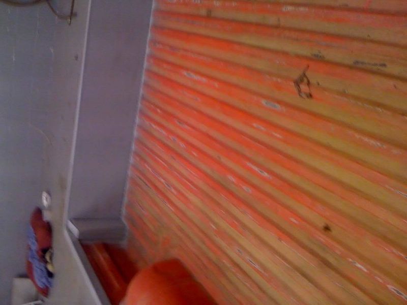

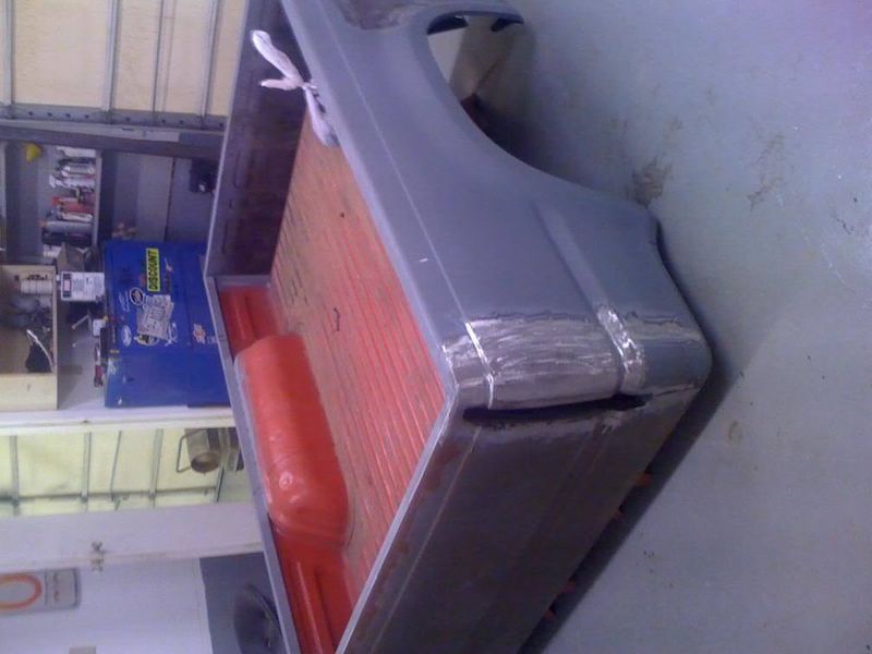

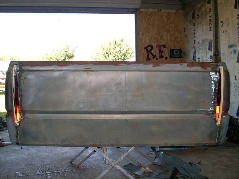

juiced mazda where did or how did u weld the bed sides to the top of the box rails????
speedster93b's avatar
speedster93b
use your stock door. take it off and cut the flange so you can hammer it flat. its already the right shape, just a little small, so if you flatten the flange, essentially your making it bigger. clean off your paint and weld it in.
juicedmazda
watch ones
juicedmazda
tack weld on top as you can see but most of the weld is between the sides of the bed and floor it self
