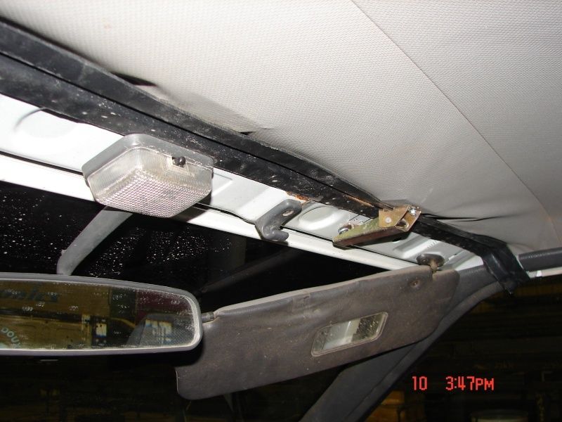

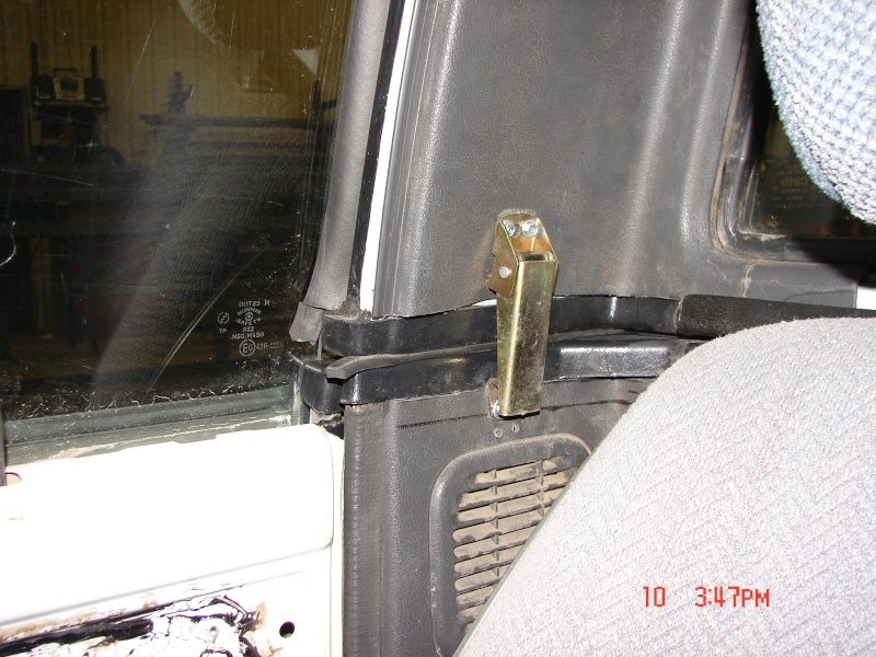

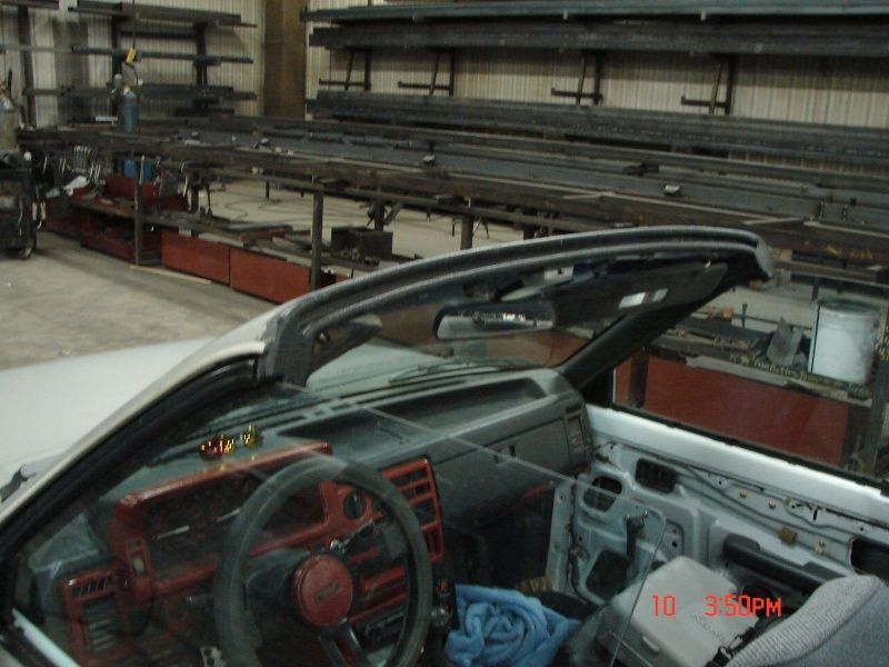

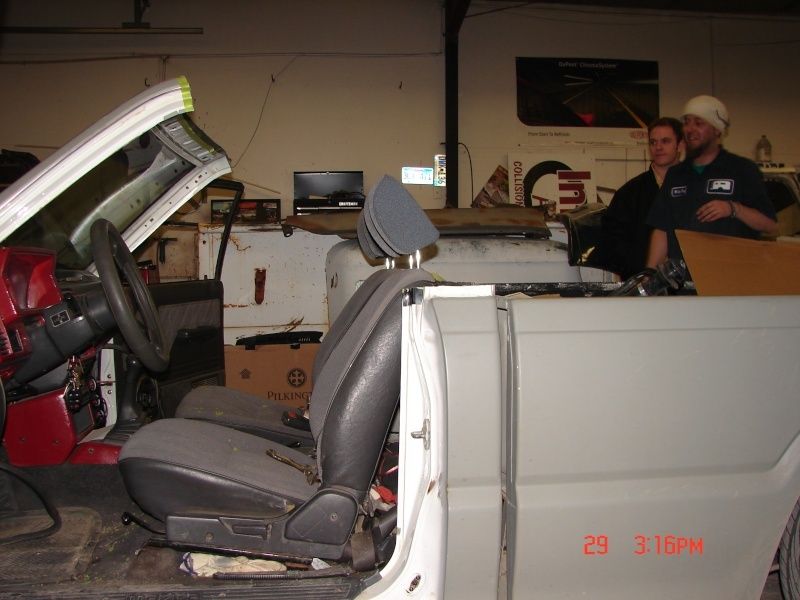

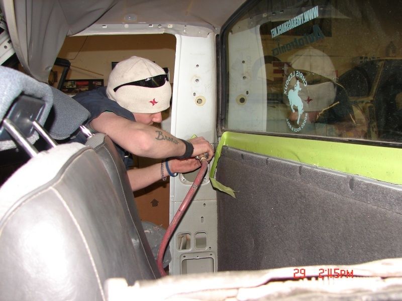

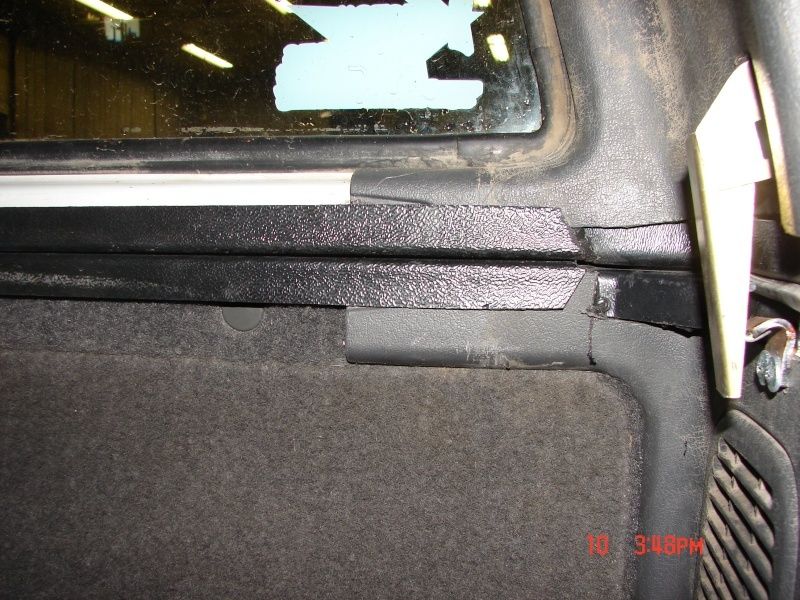

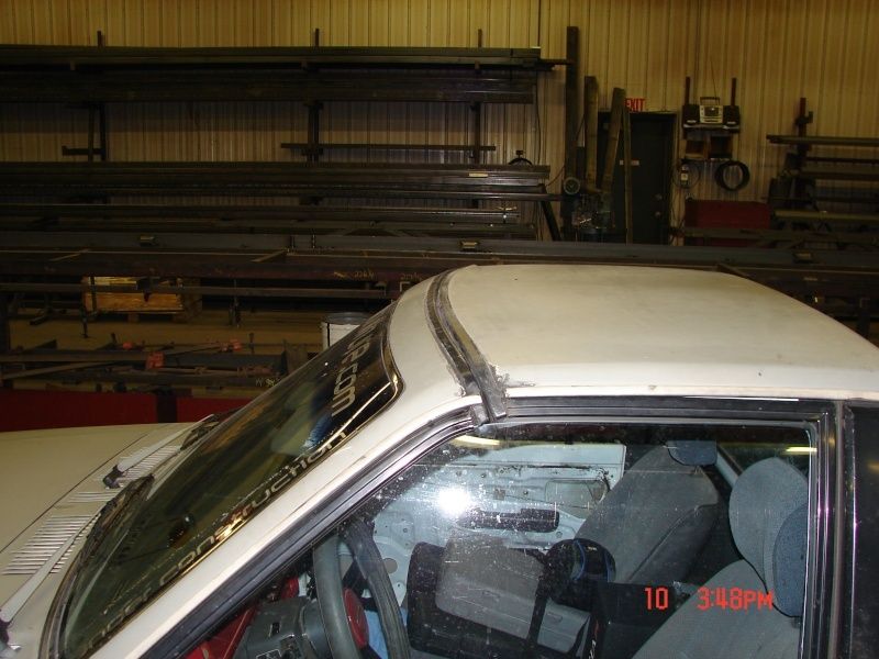

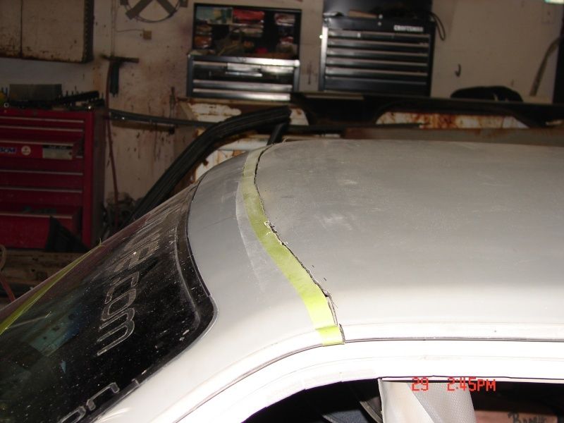

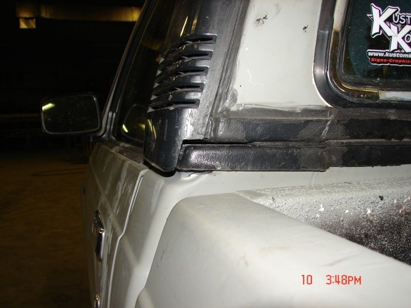

ya, i just did one on mine. the kit from aim isnt all its cracked up to be. and their support is only around during the week. a buddy of mine that works at a body shop did mine for/with me. AIM concentrates more on the front side, more so than the back cab part. take your time, dont rush. measure, measure, measure! we took about 2 hrs measuring and taping lines before we finally got the nerve to make the cut. Using a body saw(small air saw) works well. using a cut off wheel, and sawzall is required. AIM doesnt supply any adhesive, but we used body panel adhesive to attach the ABS parts to the truck. there is a lot of tiny mods to do, alot of tiny things to figure out. like the latches. they dont give you any locations or stuff like that. you just have to figure it out. the only suggestion i would make, is the location of the front cut. i they say to use a 4" measurement from the front window trim. i would say got 3". it helps doing that by giving you a point inside the cab to put your front latches. i will go out later this morning, and take some pics to show you what it ends up looking like, and where and how i made my attachments. badhkn(rick) may have some help with this also, cuz he started his roadster this way. we tried very hard to make all cuts tight, but it will leak! the gasket they send for the front bow is too thick, and the top doesnt want to seal right. but check back later, ill have some pics up for ya!

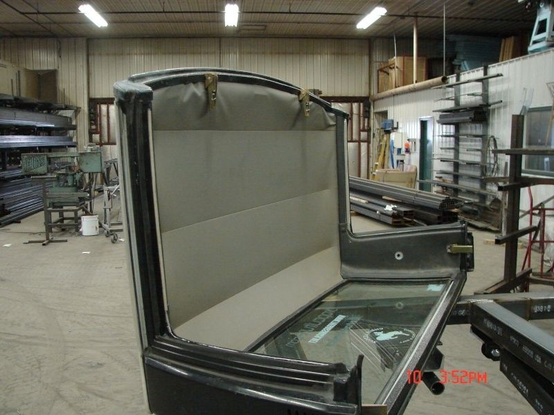

ok, heres some progress and finish pics of my top. hope they help you a little. yes, it will leak! but looks killer going down the road.
