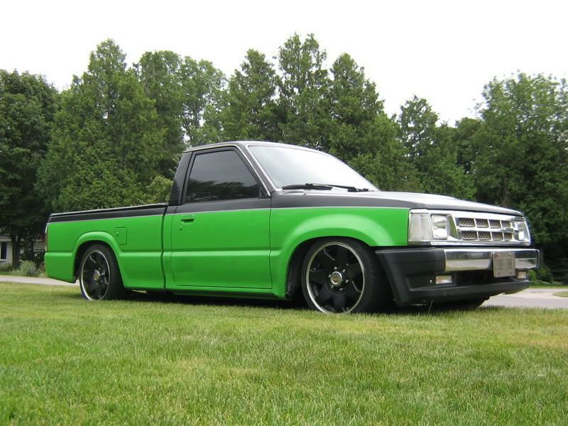

hey thanks for that link i really like how it turned out. What i was thinking with the spray paint was to put alot of clear over top to get the gloss. Do you think its possible to get gloss out of a spray bomb paint job. I don't think i would do so good with the roller though because ive tried that in my house when we were painting rooms and i could never get it all even and ive had lots of practice with spray paint.
bagged_87
I figure if you go through the same process just with spray cans and take no short cuts then yea, you probably could pull it off.
mazda23
i think ill do that and roll with it for a year or two then get an actually paint job.

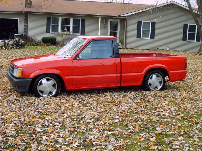

This is a $120 rattle can job. Have fun dude!
I sanded the whole truck with 320 and then used a 2k urethane primer. Drove it like a year in primer and then spraybombed it with about 10 cans of paint and clearcoat.
The truck has sat outside all winter and the paint still looks as good as the day I sprayed it. I used Duplicolor Engine Enamel.
V
v8mazda4ever
ya i must say the truck and the paint has held up good especially for the fact it was parked at the side of the road for most of the winter and getting sprayed on from the plows going by.
