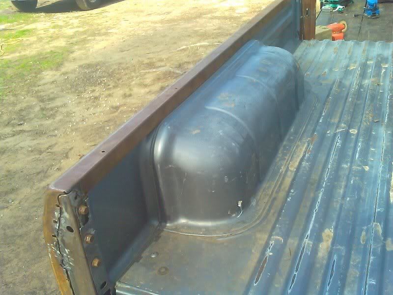

ok well i took everyones advice and decided to just replace the floor. i started cutting the old floor out today but due to no shop and it started raining all i got cut was one side and along the tailgate as soon as i get the other side cut i will post some pics
outkastdawg's avatar
outkastdawg
well it stopped raining long enough to day for me to cut the other side but i still gotta cut the supports in the fender wells out then its off to be blasted again before i install the new floor

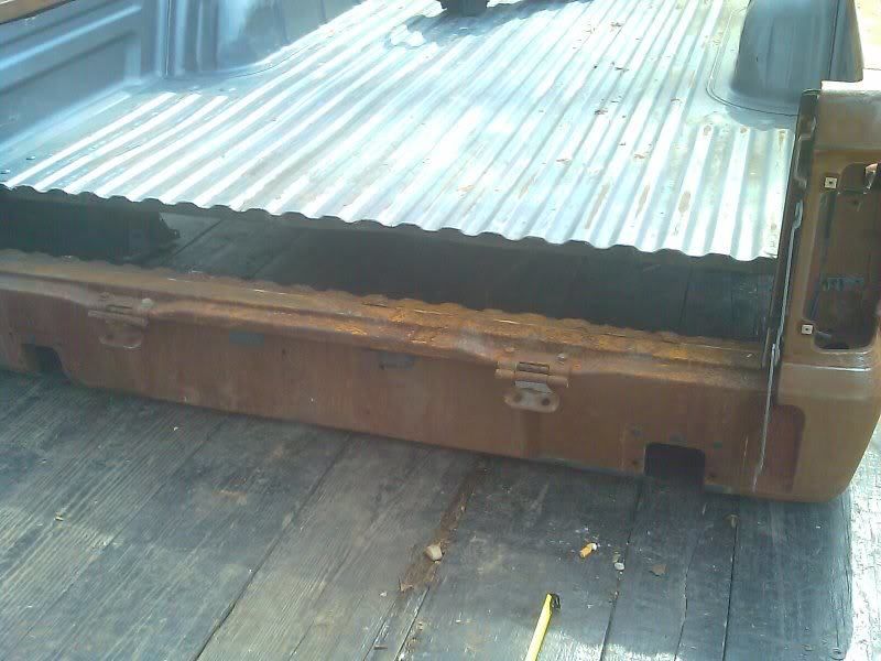

well i got the rotten floor out now i gotta get the sides ready to be sealed and primed and get the other bed off the truck and cut the floor outta it and into the 4x4 bed and trimmed for the body drop and weld it back up and bed line it and ill be all done
outkastdawg

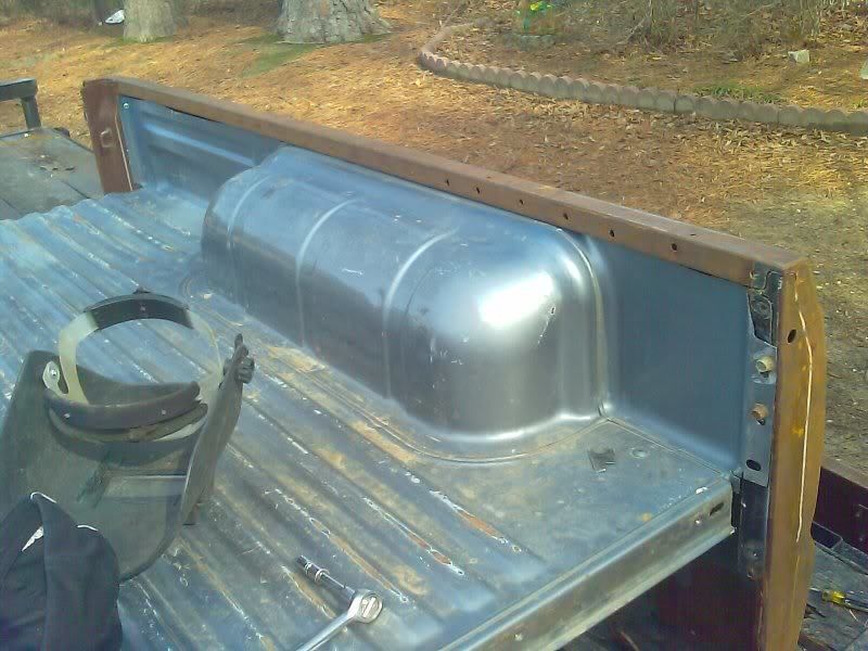

i got the bed off the truck today and got the floor cut out now tomorrow i get to weld it back in and extend my bed supports and make my spacers and get the bed back on ill get some pics when i start welding the floor back in
outkastdawg
well i got the bed floor in today but the welder i was using wont worth a damn so i just used the original front wall mounting location and bolted the front in and i put a couple of self tapping bolts in the rear until my boy comes buy tomorrow with his welder so we can weld it in
