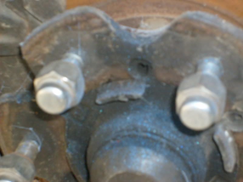

now do you grid of the tabs on the front also or just the back cause i set my esky on the other day and the bolts line up with no proble but the tabs cause it to not sit flush do i grid of all the little tabs around the center of the hub on the front.

87 mazda b2000 will take pictures to show u guys
blastation

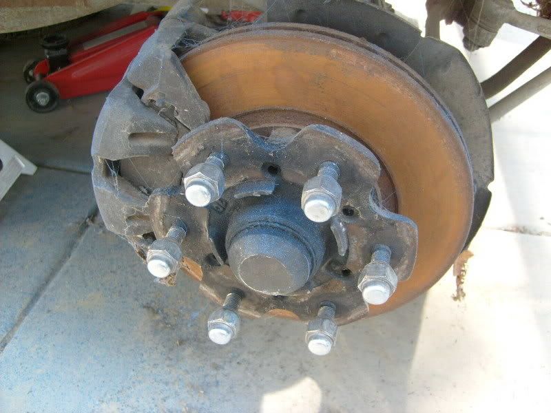

here is the picture of myhub
and here is the close up of the tabs i am talking about when i set the rim on it has about a 1/2 inch gap from sitting flush on the hub. do i grind these of also, do the rest of u have the same hub
madmazda
Yea, grind those tabs flush. Same with the rear, they'll be abit larger though, just make sure your rims sitting flat again the hub afterwards.

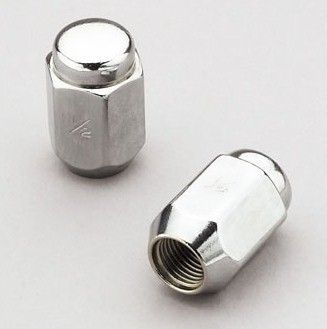

any pictures of "bulge seat lugnuts" as I have never heard of them before...

i used spacers for the front

The taper is what your looking for...
^^^^actually you need the the ones with the molded bulge at the top of the taper
