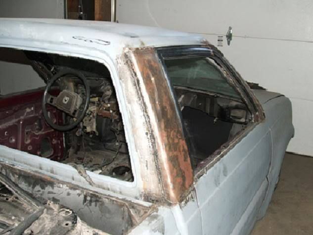

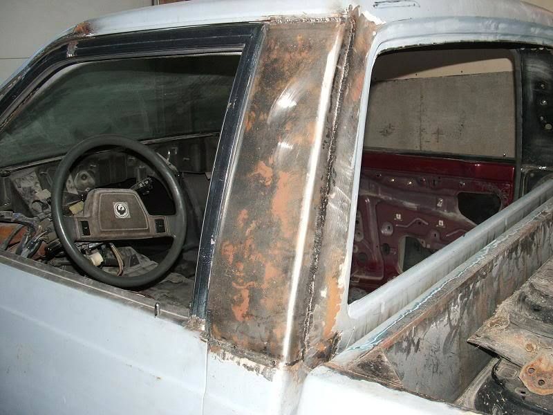

I don't use poppers, had lots of problems with them, all i do is go to the auto wrecker and get the lock rods out of a ford ranger or several other fords, the inside push lock part. it has a screw on crome cap on it. and it just bend the rods and hook them up to the latch inside then have them come out outside the window, pretty easy i think, then i just get an alarm with power locks, heres a couple pics of what my mazda has, except now mine are moved to the front because of the suicide doors
hope thats gives u guys some ideas
