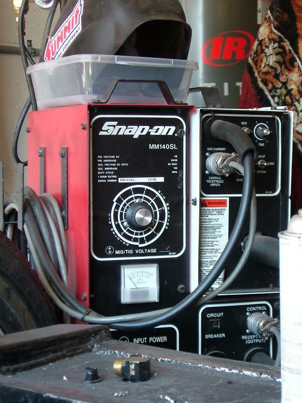

i use a snap on 110. i can weld frame work up no problem, great penetration. what you need to look at when getting a welder is the hertz, not the volts.

Not totally true, the input voltage is important but output amperage is what gets the job done.....And there is not a 110 mig welder that I have found that can put out enough amperage to weld 1/4 plate and most can barely do 3/16 single pass on full heat.
trashed's avatar
trashed
this one sure can. never had any problems with it.

That snap on should do the job...I have never seen a 115 welder that draws that kind of amperage....thats almost double the usual 110 welder draw. So in that case, yep you heard me say it, I was wrong. But for the most part, and for most of the 110 welders on the market, they are not strong enoughto do structural frame work.
phatkix's avatar
phatkix
me neither that is pretty heavy duty
