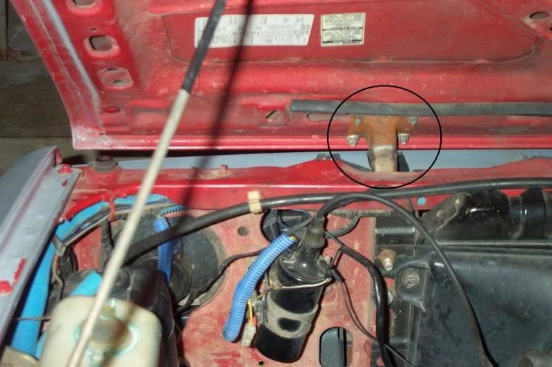

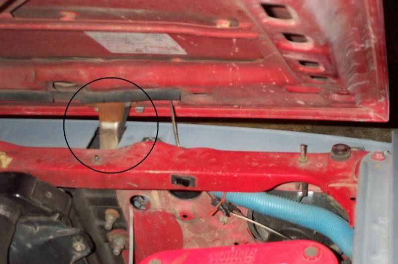

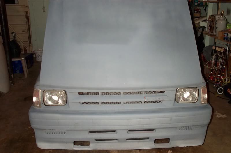

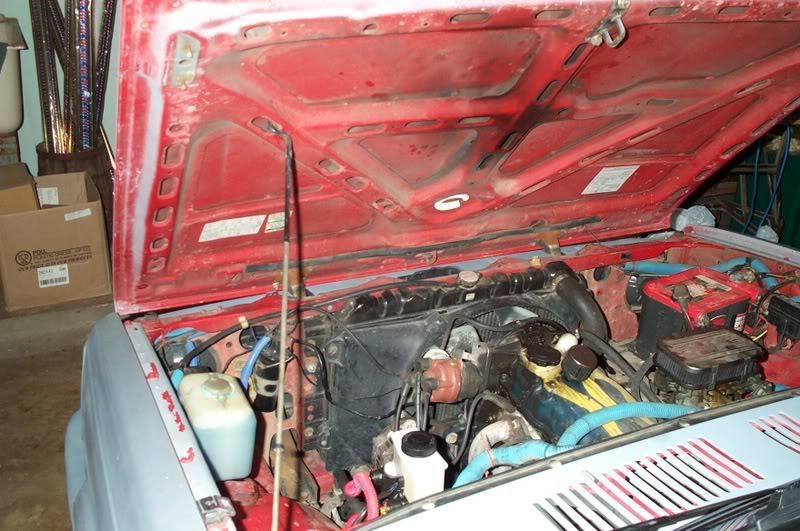

First off Sorry it took so long but I've been really busy with Christmas and all. Okay here are the pics. I'm not really sure what year honda but next time I go to the junkyard I'll look at the year and model. The pics are kinda self explain themselves. but hear they are.
Okay this one shows the hinge on the driver side. Not painted yet.
Passenger side
These two bolts are what holds the hinge to the truck on the driver side. I just drilled through and they also help hold the radiator.
Passenger side same thing.

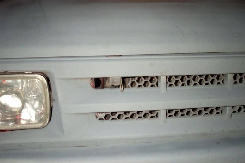

This is the only down side, the hinges do shoe through the grille which requires you to just out some of the grille.
I'll try and get some more pics of the hinges caues I gotta take the hood off since I just wrecked the truck this evening.
