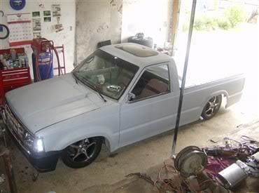

yea mine are shaved u just have to cut the drip rails off but if ur gonna do it cut little by little like 5 inches at a time and keep tackin the part u cut back together so your roof will not seperate, the drip rail is actually kinda like a seam where the roof meets the pillers and thats how its held togeter, you need to cut the drip off and tack the skin back together the hole way then just grind it smooth.
baggedb22
the kool thing is usually no one notices unless they no what there looking at, heres the best pic i have on the net of them..
